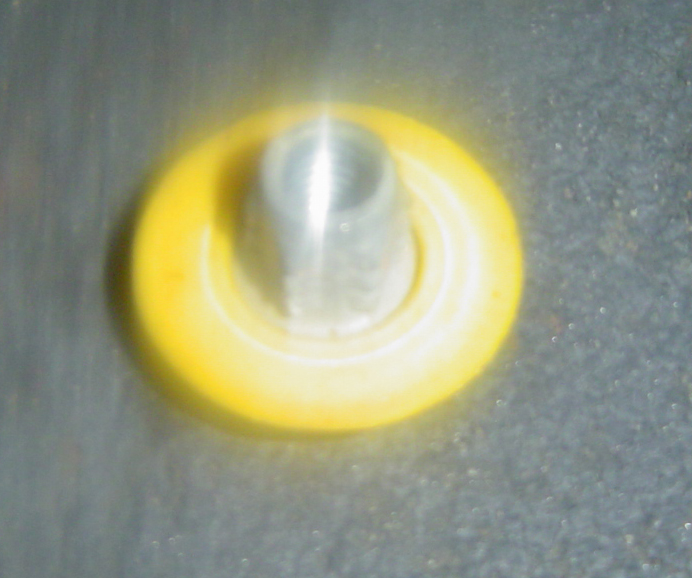

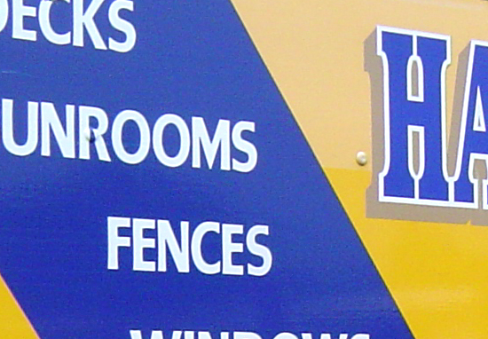

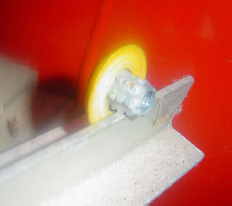

All the ones we removed are from the inside as I said earlier. You can see there is threading in there to hold the screw. They do support the walls and must be put back in. I just meant they can be removed temporarily for installation and then put back in if needed. You can see the jagged edges to hold onto the wall of the body, along with the threads in both pictures. The other is one where we went over it directly.

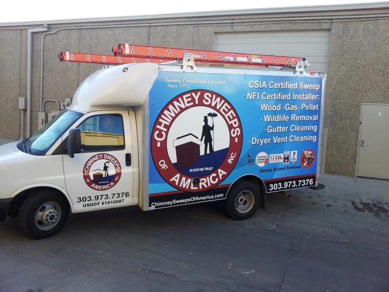

Here's one we did 2 weeks ago. we cut around each one after post heating the crap out of them.
leave enough tent to work them in without wrinkles. The trickiest ones are the ones that are inches apart...
