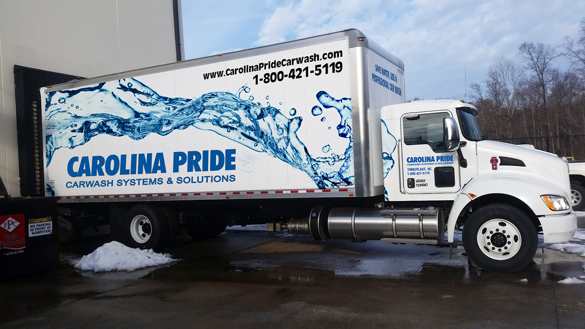

I'm going to attempt my first wrap and could use some advice.
1) Do you recommend a print and cut for the water, website text, and blue logo instead of one solid sheet covering the whole thing?
2)sooooooo many rivets. ugh! Kill me! I hear that Rollepro is the way to go?
3) Since there are so many rivets, I was thinking of oracal 751. Thoughts? Using HP Latex printer
I had a sample of 3M IJ1802 control tac w/comply, and boy oh boy, I couldn't stand the smell of it when it went through my latex printer. Stung my eyes, the aroma was so pungent. Why/what made it do that, and does the Oracal 751 have the same issue?
4) Laminate the vinyl, of course, got any recommendations on lam stock? I use Advantage as my supplier.
Thanks all for your help..obvious newbie here.... The good thing is, if I screw up the job,it's ok, it's one of my company trucks and I can just redo it.

1) You could go either way. A bit more prep with the vinyl on print/cut instead of straight wrap. On the other hand, lot less issues with rivets.
2) Rollepro
3) I stock Avery 1105 RS EZ and DOL1360Z, I would use that if I was doing it. Do you mean Oracfol 3751RA? 751 is a regular cut vinyl Oracal is much more aggressive than Avery when installing tho (Adhesive).
4) YES. With Avery use DOL1360Z. If you go with Orafol 3751RA use their 290 laminate.

Full wrap, don't cut that out. The avery suggested would be my first choice, or 3m ij180cv3 each with matching lams. Don't use the 751. Its not a print media. Rollepro the rivets or use a soft foam paint roller, like the 4" ones.
Or send it to a wrap shop in the area....hint hint...we are in NC and not to far from you. Could easily knock that out in less that a day.

Do it all as a wrap, you're actually going to waste more material and time doing it all as print/cut. Use quality cast material with air release and appropriate laminate.

only going to answer the first two since you use a different printer/material than us.
1. Decide what matters more to you
cut graphics - Pros: less material used, more flexibility in laying it down (can cut between lettering to make application easier and correct install mistakes) Cons: more prep with weeding, taping, and possibility of cutter getting off. Will have a harder time with rivets on cut vinyl regardless of using the rollepro.
Full sheets - Pros: less prep. Much easier to create the channels and rollepro the crap out of those. Cons: less forgiving with wrinkles and install flaws, Uses more material.
2. Yes rollepro it up - but absolutely use an air release controltac vinyl.

Full wraps on sides, for sure. You're wasting a small amount vinyl doing print and cut, and you're adding a lot more labor doing so. 4 or 5 full sheets on each side, pretty quick install. No loading plotter, or hand cutting on table.

We're a carwash equipment manufacturer that has an inhouse print department. I make decals, banners, and laminated signs all day long for my company and over 3000 customers.

Ya'll are very helpful, thank you. Next question.....wet install vs. dry install. Avery needs to be heated and shrunk, right?
eahicks
Good lord, not wet. That is why you use air release vinyl. And heat is not used to shrink anything....more to conform; in this case, to conform to the rivets.

Love Avery MPI 1105...been using it for years. Full wrap, but if you're uncomfortable with getting the type straight, you can cut the type & overlay. Little more work, but easier installl.
Never wet install with EZRS. Feel free to call me if you need some phone support.
