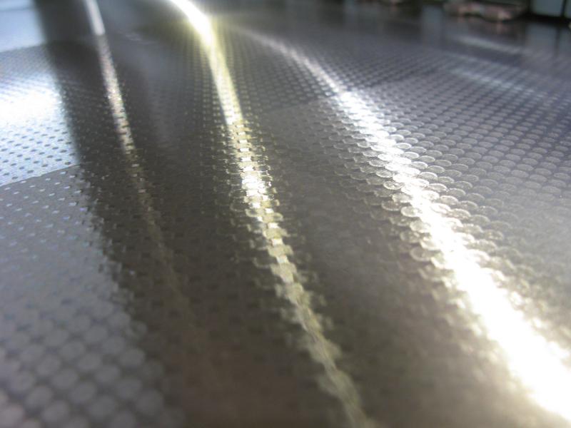

i do get to fart around a good bit. who says you have to have a uv lamp on your printer to print uv? just blaze it with a uv wand after printing...
here's uv clear on aluminum. neato!

That IS cool artbot.:thumb:
