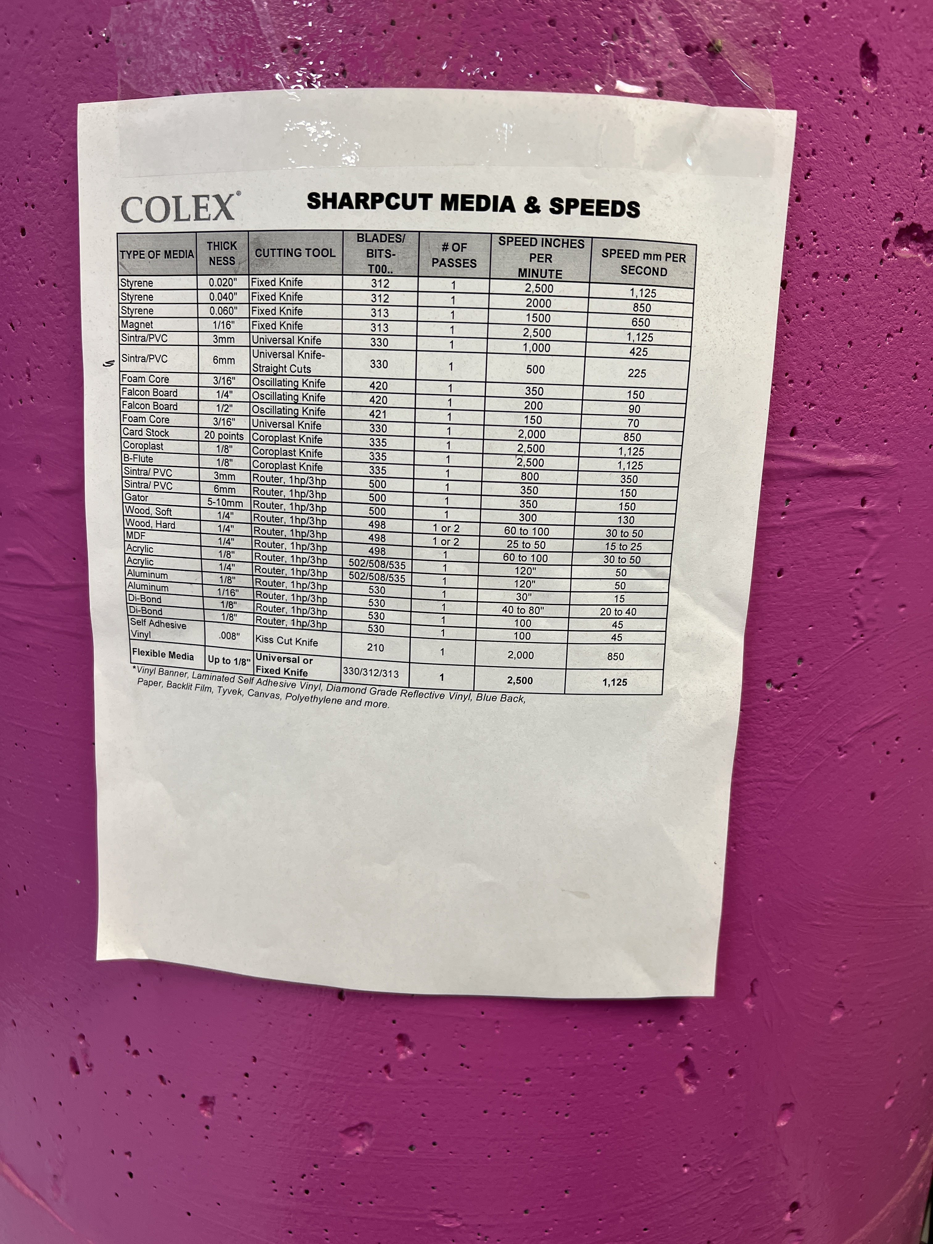

Sanity check, please. I’m estimating a 40mil styrene job, 4”x24” for 90 pieces, let’s say. I can fit 33up on a 48”x96” sheet.
I don’t want to over produce, so let’s say 30 pieces per sheet I will cut out of 3 sheets. Thats 58” per piece so a total of 1,740 inches per sheet. Does my speeds and feeds sheet indicate that at 2,000 ipm my Colex will cut out all 30 pieces is a minute or so? F03E5C8F-82BC-4CAB-A4AB-8F9780BF90DC.jpeg
Not at all, that is traverse speed. There is also lift, move, etc that eats up time. I also cut our cut speed in half to calculate machine time.

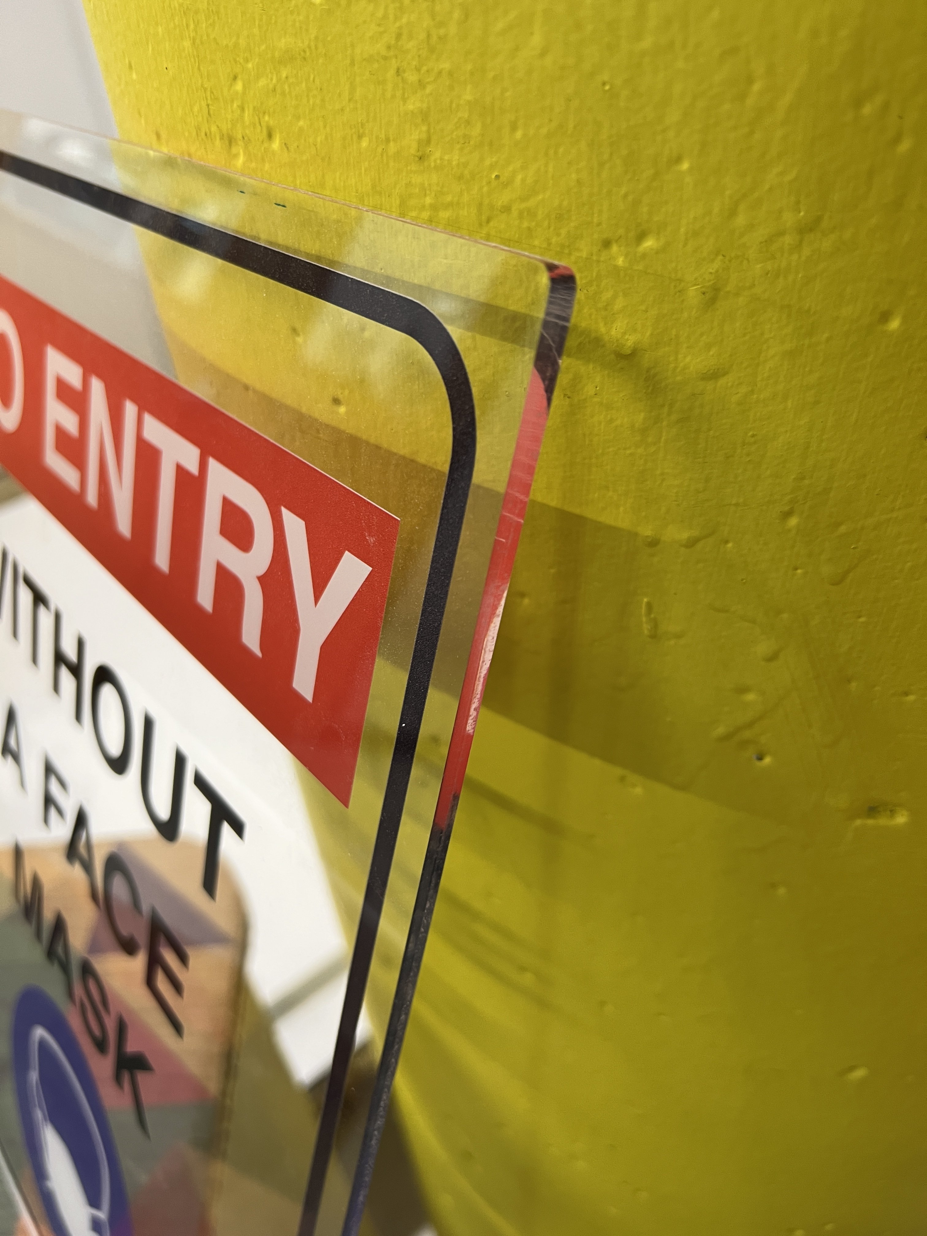

Just looking at your sheet I am curious to see what the edges of your 1/4" acrylic look like going through in 1 pass. And do you have the 1hp or 3hp router?
As for estimating couldn't you just cut 1 piece out and multiply that by how many ever you need? Colex gives you a cut time at end of the job anyway. You could also do a dry run of it, if you know your blade settings and feed rate, just throw a dieline of the job in with nothing on the table, set your Zdown to .5" run it and comeback and see what cut time it was.

We have the 3hp router and acrylic edges on1/4" look clean but we do 2-passes and IMG_3383.JPG use media intended for CNC. In some instances we will do as you suggest: Run the tool an inch above the table and see what the time is. In this case, I have about 5 scenarios with varying size and media that I need to quote, so I can't do that exercise for each estimate. I am making the habit of cutting those speeds by 1/3 or 1/2 depending on media. Thanks for your tips.
