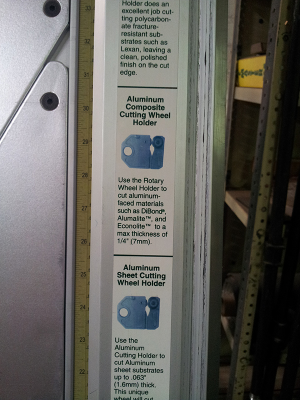

Before you start bad-mouthing someone or something, wouldn't it be kinda normal for YOU to specify what model YOU have ??
Post up a picture of yours, if you don't know what you have.
In my review, I'd hafta say Fletcher is a very good tool..... if ya know how to use it.

I have the FSC model and my sticker says the same thing Gino, and that is where I thought it would work but after trashing the wheels Fletcher-Terry said it won't cut material that thick. I have sent them videos of me cutting and they said I am doing it right. They have sent me multiple sets of blades because they did say they had a bad batch but after a year of new blades and replacement parts I still can't get it to cut aluminum composite accurate unless I use the blade for soft material. The tool cuts the aluminum composite it just doesn't cut it straight. If you have any tips on getting it to cut straight I would greatly appreciate it.
