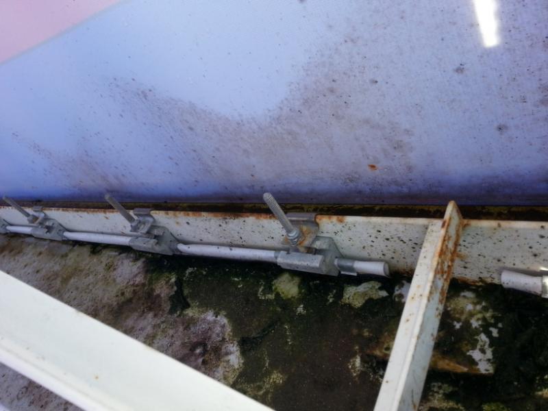

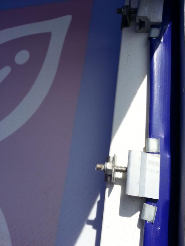

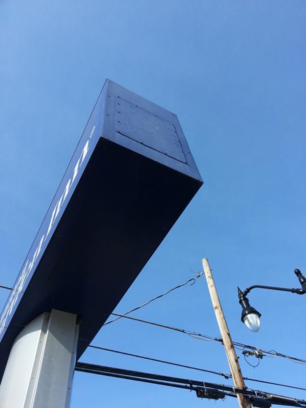

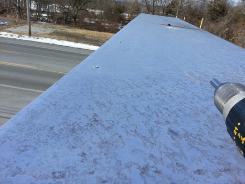

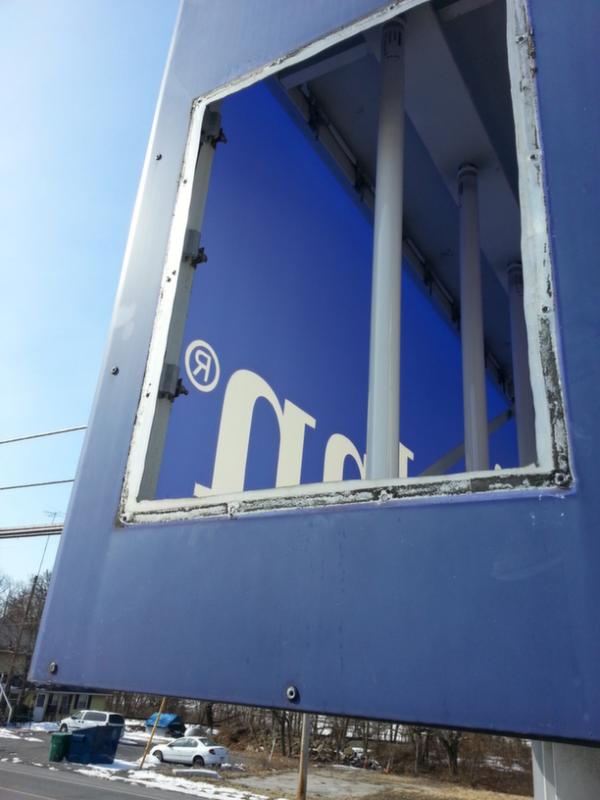

I've been asked to quote my first flex face. I've never done one before but want to learn how. I've attached pictures of the current sign. Customer is asking us to replace both faces. It looks to me like I have to take the aluminum panels of the sides, top and bottom to be able to get access to all the tensioning hardware. Does that seem correct? Looks like we'll have to drill out all the rivets(aluminum so not too bad) and reinstall with rivets or screws. Does anyone recognize this tensioning system so I can look it up and gather more information. The current panels are blue/purple and red translucent vinyl. Is the same kind of vinyl used for face as a normal translucent? I was kind of surprised how nicely the vinyl was shaped over the corners but maybe that's just because it was tensioned well. I'm sure there will be a little bit of learning curve but any help or tips would be appreciated.

I haven't seen or replaced a flex face with a system like that which tensioned on the inside. I believe you are correct; you will have to remove all the panels to replace the faces using the current system. Tensioning that system appears that it may be a nightmare to me.
I would probably try to sell them a retrofit face consisting of a frame and 4" retainers. Cut out the existing face and remove existing hardware (should not require the panel removal as far as I can see). Install new face to retrofit frame on the ground, lift and attach to cabinet, finish tensioning and install new retainers.

3m wedgeclamp system. it is actually the most popular system out there for the Very large flexface signs you see. Such as all the large hotel chains and highway signs. Reason being they are extremely cheap to produce( all 2x2' steel angle perimeter frame). these just hook around the angle and you tighten the 1/4' bolt with a 7/16" socket on an impact. You are correct, you need to remove all the top bottom and side panels to do this. Sometimes the builder will screw the next guy who has to reface these in place because they can sometimes sandwhich the bottom panel between the plate of the pole and the angle frame. making the bottom very difficult to tension. You need to do a great survey of the bottom of that sign as i see it has a pole dressing on it. make sure you do not have to remove the dressing to remove the bottom sign cover! They look scary but after doing one or two you wont sweat it.

I'll look into a retrofit. Unless I'm missing something there is no way to reach the center bulbs without taking the top off which is riveted. There are access doors on each end but they are only about 18" x 24".

I'm 5'7", 160 lbs and I don't think I'm fitting through these access doors. I'm kind of getting off topic as it's replacing the faces that I'm really concerned about. I'm just keeping servicing in mind.

about how big is the face? Just re stretch a new face on there and service it while its apart. When it comes time to service you can take the panels off. If the customer has money to spend you could make retro frames with top hinges. Jump in and get wet they are not that difficult to change out. Where are you located

It's not real big, about 42" x 138", about 10' off the ground. I'm in Hanover. Sign is in Gettysburg. I'm just going to stick with the flex faces.

FlexClamp system by SignComp.
Install instructions are most likely available via their website or a few emails, I haven't had to look in quite a while.
they're pretty straight-forward. I wouldn't sweat it. Look into UltraLon IV for the material and make sure you save every-single piece removed...or you'll have to buy a box of like 250pieces to replace just a couple.
Excess flexface material wraps around a metal bar, that slides into the tensioning clip, and is tightened by the nut you see on the back-end.
when it comes-down to actually tightening the faces, make sure you tighten opposing clips as you work your way around the sign face. Snug at first, and then dial-in the tension on the second go-around to pull-out all the ripples.
...also, never ever attempt to pop bubbles in your graphic with a blade, as piercing the flex face WILL lead to failure. If not immediately, then definitely over-time when wind/weather beats on it.
