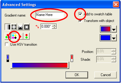

Did you set the gradient color mode to CMYK? The gradient color mode should match the colors that comprise the gradient. You can do this in the Advanced Settings tab. You can also add the gradient to your swatch table from this tab.

Yes, I did set it for CYMK but it seemed to keep switching back to RBG. Was acting kind of squirely too. The first node color on the left (using Rainbow Fill) is RED, so I would make sure I was in CYMK mode and then I would change the node to my good red which in this case is 0-100-80-5. When I click OK the rest of the colors disappear and the whole thing turns that solid red. Very frustrating. It's acting like it won't apply the changes and reverts to the default RGB rainbow. :banghead:
Just dawned on me that maybe I need to manually reset all the nodes? But then again, when I switch to the CYMK mode it should switch all the colors to the relative CYMK values and that should not be necessary unless I want to tweek them.
