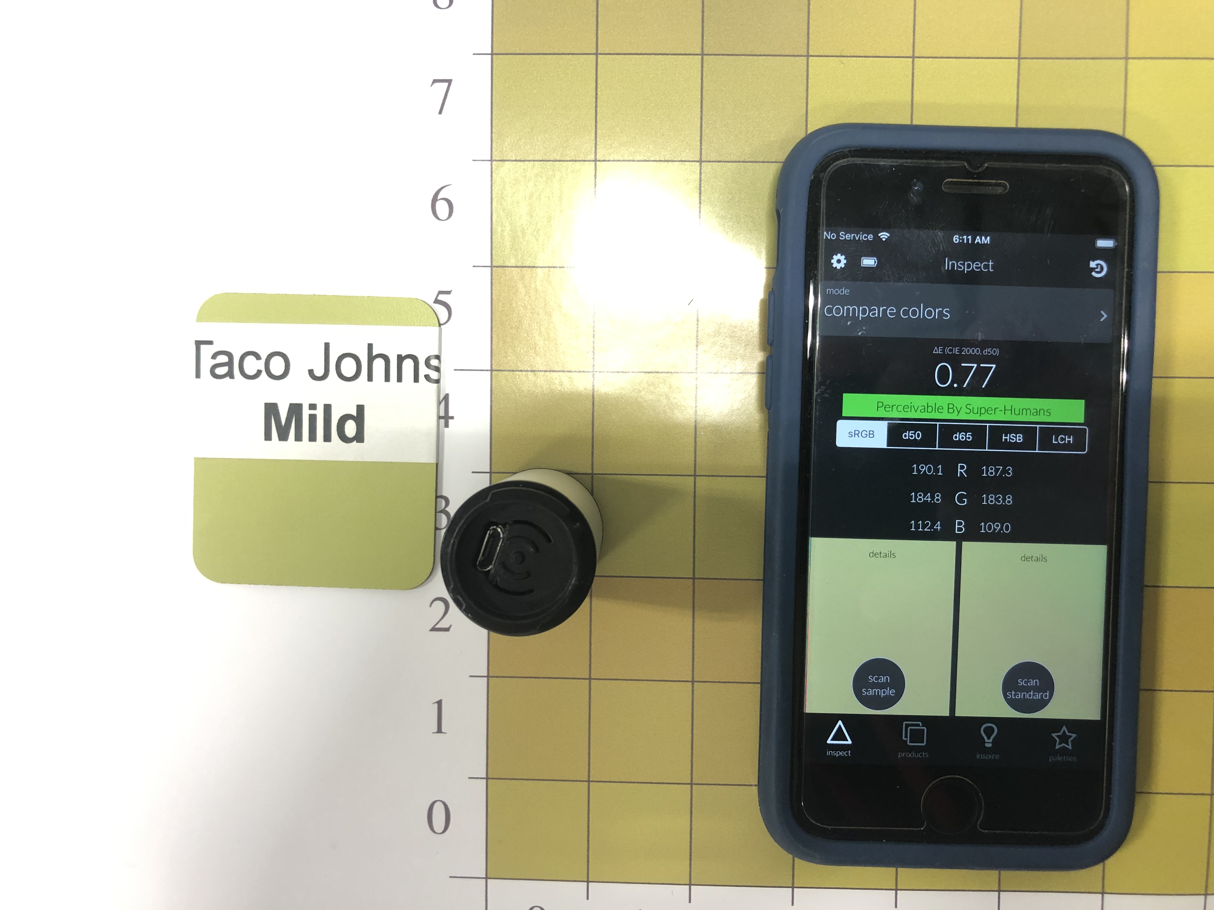

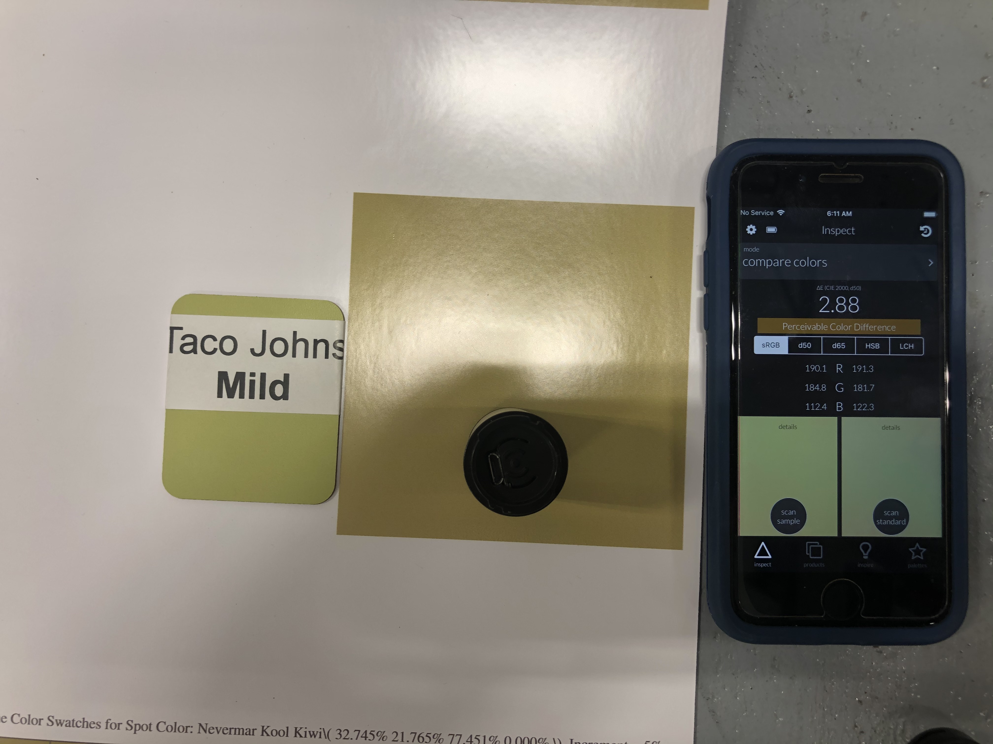

Holy crap I completely forgot about this thread. I have been so busy with jobs that didn't need color correction or have used our other printer with is dedicated RIP software. So back at it with color mapping. Still having troubles. don't know what to do and SAi is not be very helpful and there are not a lot of good vids on this. I attached a couple of recent photos I took of trying to match a laminate color. I get under 1 dE but then when I print a swatch of the same color its completely off. SAi says that the spot color needs to be named exactly what the mapping color is and they are and I am still getting this type of result.

I would agree with SAI....the color name HAS to be the exact same as what you designate in the file. If the file color is "PANTONE 547 C" then the color mapping you create must be the exact same. If you create it as PANTONE 547C" it will not work. Or Simply as "547 C". It doesn't care what the color is, just the name itself. I have had good luck using the color mapping. If I see the color in question is off, that means all colors are off and it's usually something else causing it.
And note... I am still using Flexi 12. I have seen so many reports of color issues with 19 I have not bothered to upgrade.

Yes the EPS file you create. And you can delete afterwards, sure. Once you save the color in the mapping process it never looks for that file, it only produces that color based on what you set it to output.
