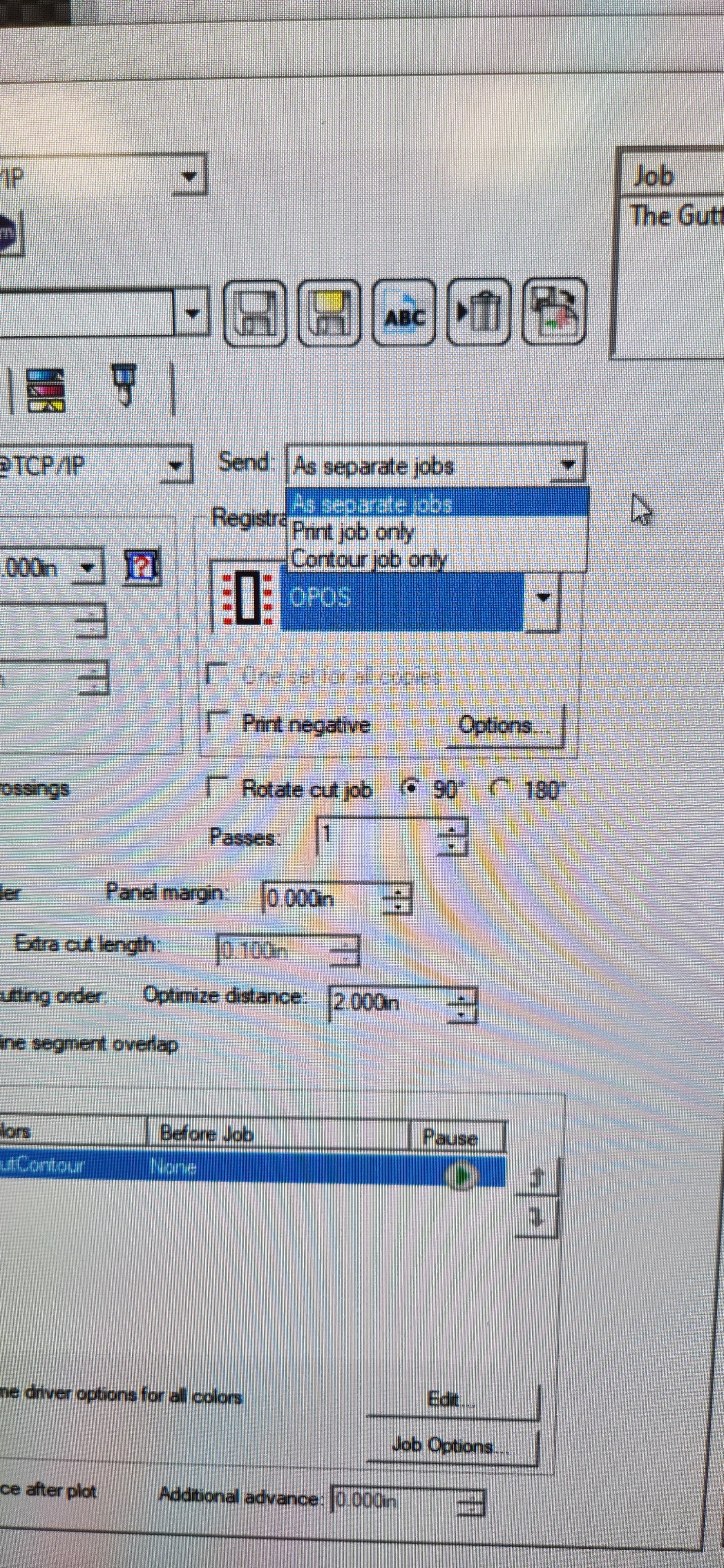

Yes, there is a selection in the top of the 'Rip&Print' dialog box tab to the right is the Cutter Settings tab, pulling down the arrow allows for sending 'Contour Job Only'
Hope this helps!
-N8

Where is that option? I can't find it in Flexi 22
When you highlight/select a Job and hit the Rip & Print (Ctrl+H) icon in the toolbar(not the desktop print icon).
When window pops up, the selections are in a pull-down at the top right of that window.
Found it/ It was located in Production Manager > job properties > workflow > send. Although my layout looks different

I have all my jobs set to "hold" once it is sent to PM. We use multiple plotters, including graphtec. When we send a file to PM we get 2 files that show up. 1 is the print file and the 2nd is the cut file.
We dont have to print anything for it to have the cut file in PM. There is a setting that says "send job separate to cutter" or something along those lines. Maybe that is why yours is not showing up till you print?

Thanks, I’ll have a look at that option.
I’ve print and cut a few jobs today and it went quite smoothly. I like how easy it is to get the width of the printer and setup the cutter. Now to play about more.
