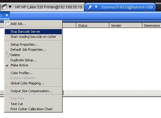

Definitely flexi barcode server is on (there is a message at the bottom saying barcode server is on).
Same old problem. Load the opos, machine read well but doesn't start automatically. I need to drag the file from hold list to output.

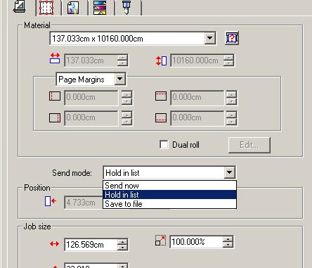

I've tried the sendmode, etc.

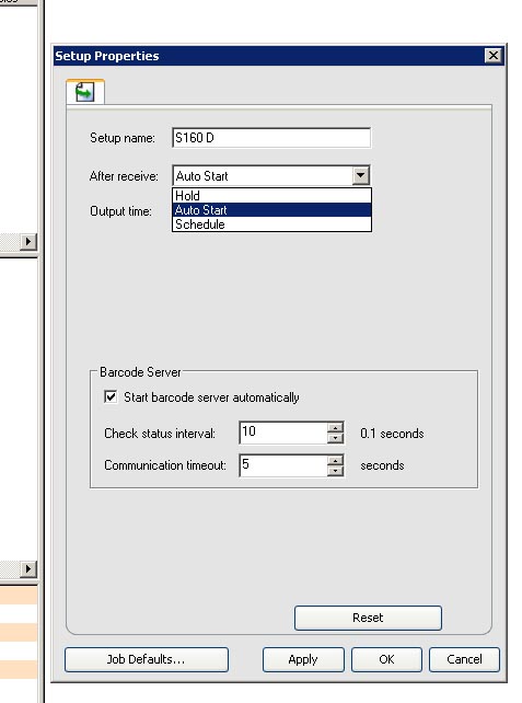

Please refer to the attachment for the setting I used.
