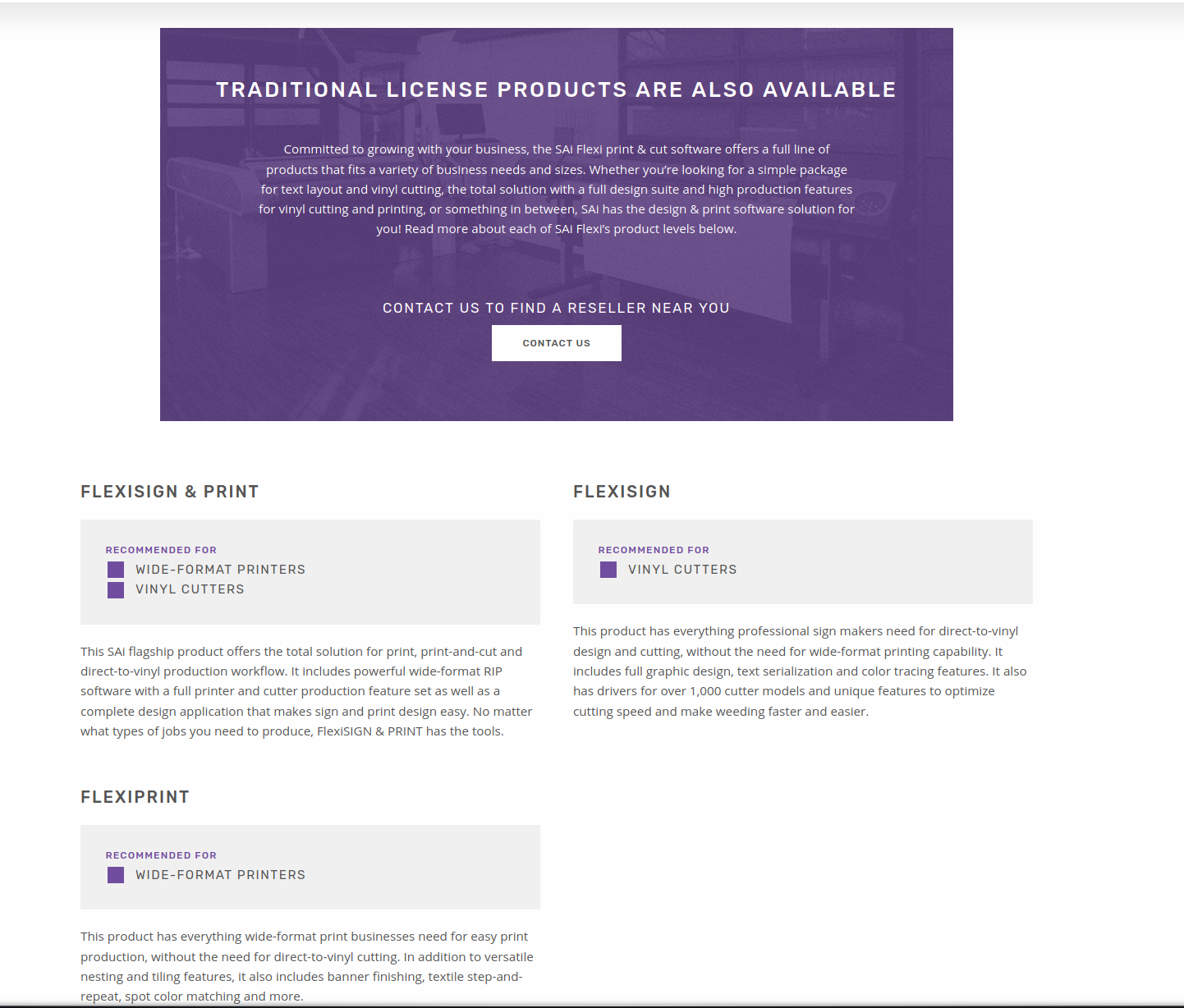

letterman7
WWD - I'm Windows based. Bal - I looked on the SAi site and all I saw were monthly subscriptions. I'll have to look again for a permanent license. I'd rather do a single outlay of cash than a monthly bill.
WildWestDesigns
letterman7 , they try to make it not very easy to find. It reminds me of what Qt tries to do when one is looking for the open source versus commercial version.

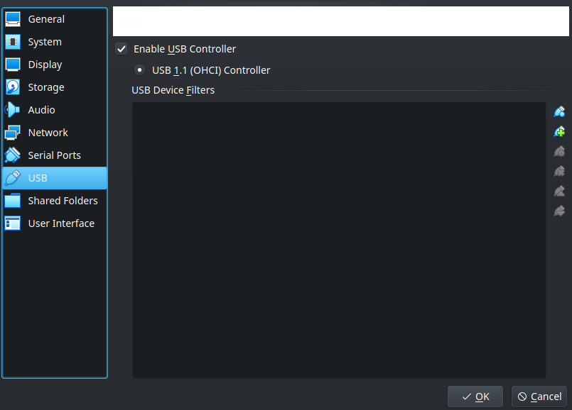

We (my computer guy and I) actually tried that. It wouldn't recognize any of the dongles for Flexi or Corel (I run CoCut). Spent about 3 hours trying to figure out why it wouldn't find the dongle.. never was able to.
WildWestDesigns
How did y'all try to pass the dongles through and what type of dongles? Install the needed drivers etc?
letterman7
I have dongles for Flexi, CoCut and a third for a Summa cutter. We fired up the computer, went into VM then plugged in the dongles. The machine never even "saw" them.
WildWestDesigns
Ok, I'm shooting in the dark here.
I'm only going by what you said in the above post.
Are they USB dongles or did you have to use an adapter to use USB etc, parallel dongle?
In general, if using USB type of dongles, did you just totally pass them through to the VM? In other words, only the VM sees it? The host does not see it at all, until you shut down the VM. If not, I would suggest making that so that the VM is the only one that sees it. Otherwise, the host would also have to be able to recognize and know what to do with that hardware for the VM to also be able to see it and use it (this is more if you installed hardware cards to get the ports to use the dongles (like for parallel dongles where most people don't have that port on computers out of the box anymore). Even if you had that type of card, I would still just pass everything through if that card too is legacy.
When you totally pass through the USB devices (still assuming that they are some type of USB dongle), did you also install the firmware (if needed) as well? I know when I was using dongled software, they had firmware that needed to be installed. Some thing here (and I would make sure that you keep a copy of said firmware in case there needs to be a fresh VM install later down the road (for whatever reason) and that firmware (for whatever reason) is no longer able to be had) I would assume.
You may have done all this and more, but I don't know based on your response. Just in case you have done the above already. The above would be the easiest method of doing it, if that didn't work, it's getting more into use IP configuring for the hardware and that is exceptionally tedious.
letterman7
They are USB dongles. I'm not sure what you mean by 'passing through' to the virtual machine; we had VM running when the dongles were plugged in. We tried going through the settings of the device manager and they weren't even listed. So.. right now it's a moot point. He was able to secure a Win7 compatible motherboard yesterday. He cloned my machine last night and will be working on fine tuning the new machine over the weekend.
WildWestDesigns
Whatever VM software you are using (I use VirtualBox, but VMWare is a very good paid option as well and it is cross platform on all major desktop OSs (including Linux)) and look in the USB section of settings. For VirtualBox, it look like the attached (I don't have any USB plugged in devices that are the old school 1.1 (I don't have guest additions installed to get 2.0 and 3.1 support, but those are supported by virtualbox with guest additions, it's just 1.1 otherwise) as I don't need USB support for what I do anymore in the VMs).
The settings, was that on the host or the guest, if it was on the guest, it will never see them unless you pass it through. If it was on the host, drivers for those dongles would have to be installed first before the host would see it and thus make it available for the guest to use. When I was running embroidery software, in that list box on the attached picture, there would be an entry that would have HASP KEY that I would need to check to perpetually pass through to the guest VM. That's the type of entry that you would more then likely be looking for in those settings.
Passing through the USB dongles (in this case) is the act of making those devices only available to the guest VM for as long as it is running within any given session. The host OS will never see it until that VM is turned off/closed down. For instance, if you were to pass thru your main mouse and keyboard to be only seen by the VM, you would never be able to switch between the host and guest until you shutdown that VM, then the host OS will be able to use the mouse and keyboard. If you double up on hardware, passing thru is pretty cool as it is truly using one tower to run 2 (or more, at the height of my craze I was running 4 OSs at one time and one VM was within another VM) "computers" at the same time.
