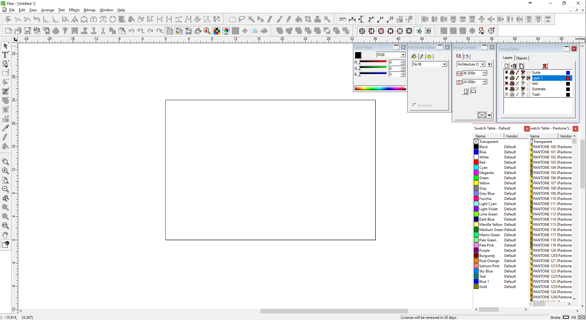

Ok I know all of the above mentioned. Workspace is irrelevant here....the toolbars are all separate groups that can be moved wherever you want, no matter the workspace you choose. I have them set a certain way. And yes, closing the app and reopening it, they are where they should be. My problem is if my monitor shuts off, then back on, they all change. Which makes ZERO sense.
Attaching a photo here....top screen is normal setup. Bottom half is after turning monitor off and then back on.
This a new problem and only happens on this PC with this Flexi Designer.

It's like what Cam said. If you turn one monitor off and leave the other on, you may notice some flashes or adjustments. It's likely The Flexi window is getting shrunk which causes the toolbars to not fit all the way across the screen. Which is why it only moves the ones on the far right enough to fit on the smaller window.

Depending how they're connected, turning off some monitors makes the computer think you have unplugged it. So then Flexi thinks the screen size changed, and adjusts its toolbars to compensate for that. Does your monitor have alternative ways to connect to the computer? My monitors are connected via DVI & HDMI, and I don't have these problems. I think some monitors connected via DisplayPort have this problem.

Same thing happens, like I said.... Turning the monitor off makes the same thing happen as changing the size of the program window.

This one is Displayport. Guess that's the issue.
