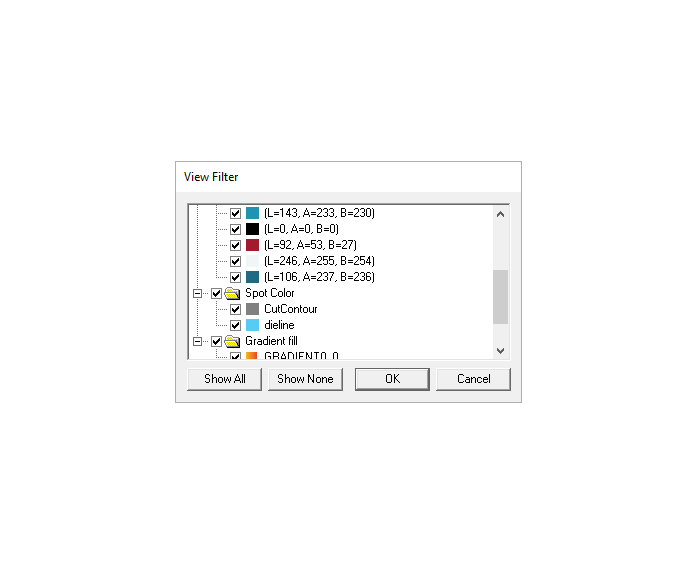

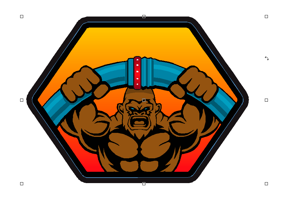

I received a file from a client (pdf) and opened it in Flexi, made my changes to get it ready for print and then I went into view filter and I see this one element and the view filter is calling it a dieline. I am curious how Flexi determined this. It really is not the dieline but a thin blue keyline that is close to the edge of the graphic but definately not the dieline for it. See attached.

The weird thing is that I made a cut line outside of that, sent a proof and was approved...I guess the client is unaware too. The reason I made my own cutline is that what looks like black on the outer edge is actually a dark grey then the blue dieline, then black, so one has to wonder why the designer would have a different colour after the cut line...just weird

"...why the designer would have a different colour after the cut line..." Because most designers don't know how to create production files. Alternately, they could have intended it as a bleed, but didn't select the correct color.
