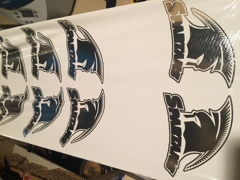

I unwrapped one of my white foils. I noticed that on this last job i ran. I did 6 pairs of decals at a time. In between and in the beginning of each run it forwards to start about 6 inches. How can I prevent hat from happening. I am pretty sure its an Omega setting.
Thanks,
Robert

I do have the Conserve Foil checked mark.
At the start of every project the edge moves about 6" than starts. I understand it does that so it has enough material when it gets to the envision but that is not cool that it does it to the foil.
1. print 2. yes to vinyl, insert foil. 3. it moves 6" than starts.
I am positive there is a way to stop the manual 6". I just forgot how to uncheck that part.

Using the Conserve Foil feature eliminates the wasting of foil where that particular foil is not needed but it also causes some problems in color to color registration. I only use Conserve Foil when each color is separate from all others. If any color is touching another, I recommend turning off that feature. It does nothing about the gaps between print runs.
The gaps between print runs is built into the software and no adjustment for it is present in the controls. The only thing under your control is whether or not to print the job instructions. Unchecking the box (F11) for this will eliminate the space used for this thus reducing the gap between jobs needed to print it.
Robert: All these suggestions are right. However if you home your printer and mark the vinyl at the 12:00 position, then print something, you will notice that it is 1.7" from your mark to the beginning of the registration mark. So if you want to do as Pat suggests and manually rewind the foil at the beginning of the job, you can. Just pull back on the little paperclips and it will wind easily. Rewind it so that the spent ribbon is 1.7" past where the print head will start to print the registration mark. You'll have to run some tests.
