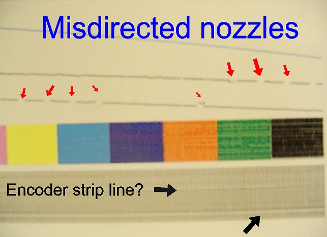

I wanted to get some advise here,
I got some misdirected nozzles on the black head. I have done multiple cleanings, manual cleanings and soak the head, and still no luck.
Any other tricks or should I replace the K head ?
Thanks In Advance !

If you spend enough time with it you can always get ALL nozzles back provided there is nothing physically wrong with the Head...
rockz12
Specializing in the strange and unusual
Soak it more! Lint free cloth on top of capping station with alcohol on it, raise the head so it will get on top of the lint free cloth. Once on top lower the heads. Let it sit for 30-60 minutes. remove lint free cloth and do a few powerful cleanings then nozzle check. Repeat as necessary!

I would soak the print head and than do a cleaning. Make a test file with solid blocks of color so each print clean ink. I have one with c,m,y,k,r,g,b, and a grayscale and a bitmap woodgrain pattern. This covers the need.

Still got misdirecting K nozzles, I think the next thing to do it is replace the Black head...
I've had the same problem with black on my FO 48" and nothing is working for me either . I think I'll have to bite the bullet too and get a new head too.
