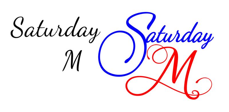

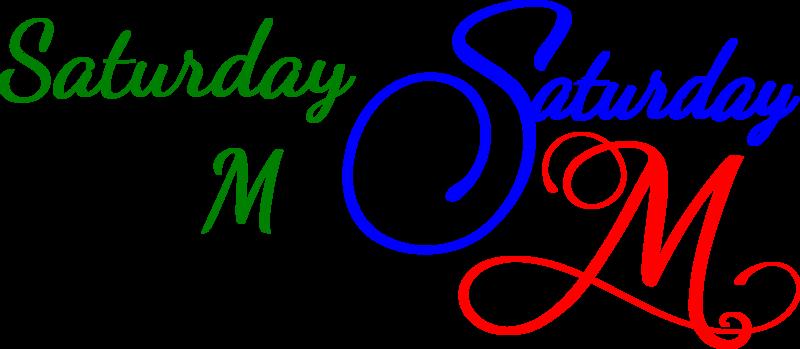

I like using Inkscape for flourishes
I am still getting used to it, but Inkscape has a feature called spiro spline for making smooth curves.
Though I'm not good (fast) at it yet, the examples below did not take too long. I would have spent a lot longer tweaking nodes and Bezier curve handles in other programs.
Inkscape is open architecture vector software that is a free download. There are a couple of textbooks in print and some Youtube videos for it.
I don't use Inkscape as a replacement but as an addition to my regular vector programs.
Adobe Illustrator can open Inkscape (SVG) files, and Inkscape can open AI files.
The black below is the original, called Dancing Script.
The blue and red are my modifications. They're a little clumsy-looking, but I will get better with use.
