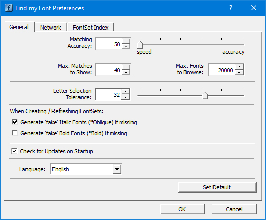

Differences in results would be affected by, among other things, the preference settings as well as the letters selected. The attached screen shot is the default except that I have increased the number of fonts to search.
You should try it again and get your own fonts added in and indexed as well as tinker with the settings. I get better than 80% correct IDs and the change perspective grid is great for straightening a distorted line of text back to the original look.

FindMyFont Preference Screenshot

Naturally the clearer the picture the better the result (yours was nice and clean), also I try to pick the oddest letter/letters and on script fonts I try to cut apart where I "think" they would normally finish not in the centre between the 2 letters...if you get what I mean.
And I haven't changed anything in my Preferences.....because I never even looked in there as it works so good as it is (thanks Fred)... might have a play with that.
