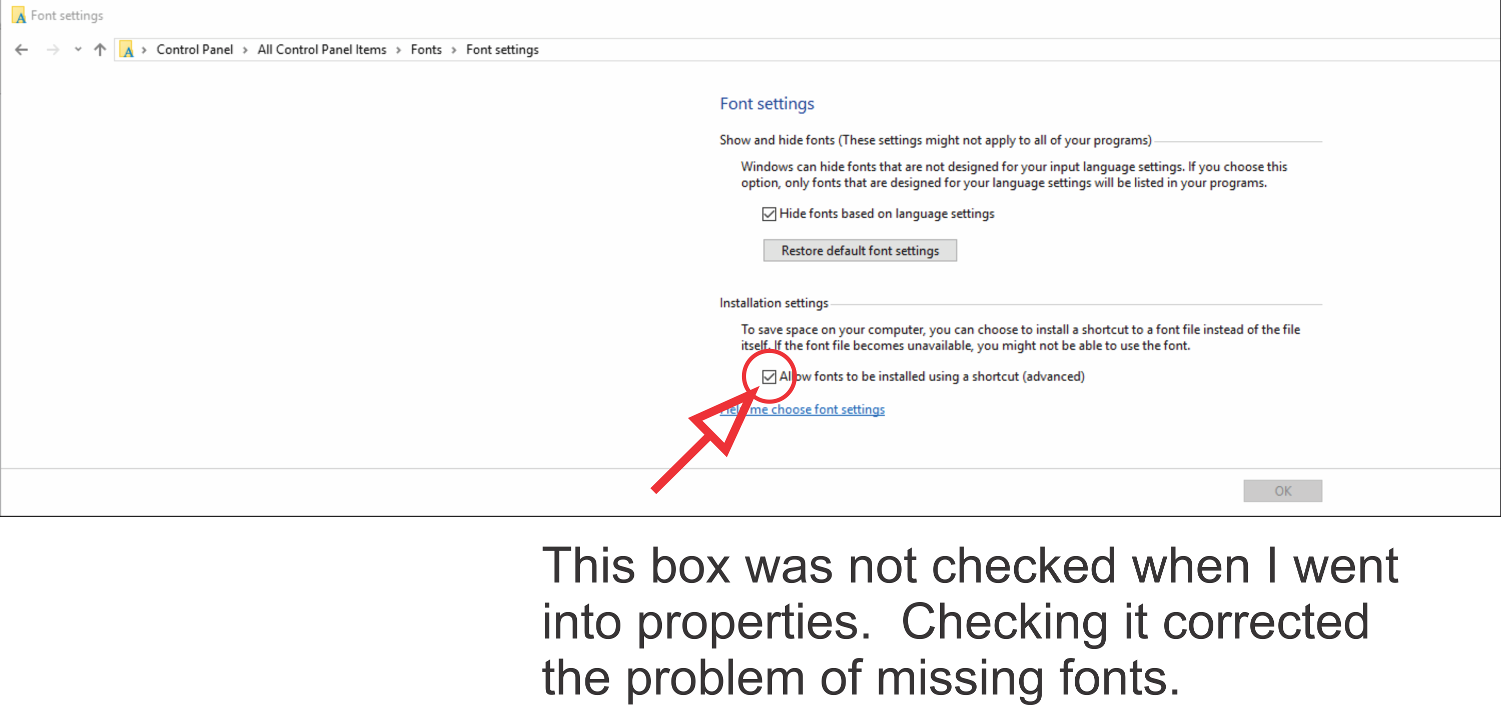

I found this box unchecked after the update. This got the fonts back in the short term but I've lost them again several times. A restart usually fixes it - but I've had to restart a couple of times on my last loss.

I just read that if you installed the fonts through a font manager that is the problem. So I am re-installing them through the Windows folder, hopefully that works.

Update: I loaded all my fonts directly to the Windows font location and it worked. The only problem is it loaded 2000 fonts into Font Navigator so I had to move most of them from the active column there. Considering Windows did this update months ago I'm amazed I haven't had problems much earlier. Thanks Windows for taking up a day's worth of my time to identify and fix the problem. :-( Thanks for you replies.

In additition to sewfun52`s answer, I also had success with deleting the fontcahce file in C:\\Windows\System32\FNTCACHE.DAT and rebooting.
