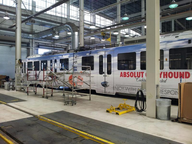

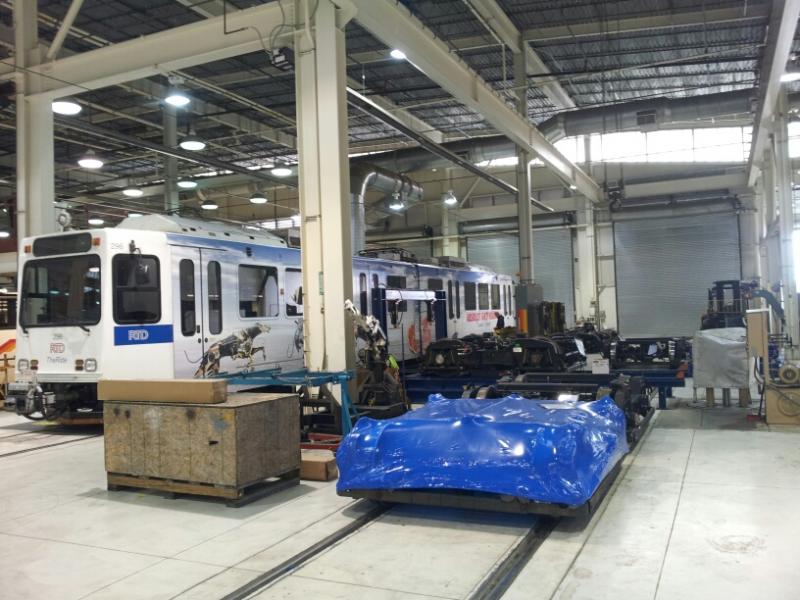

Bringing up an old thread... After Dozens of these things..
3 months later we're installing ~2k sqft of vinyl and trimmed in just over 4 hours now. We're speeding through them.
