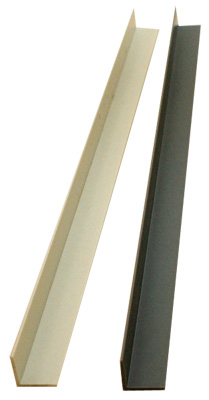

what do you use to make a frame for 4x10 alum sign mounted to building. in the past i use 1"sq tubing and make the skeleton and rivet the alum sign face to the frame then metal corner over the edges. having trouble finding the corner strips. anyone know where to get them or have better ideas for what to use for a frame
