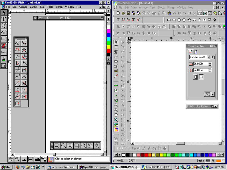

Fred- are you running flexi 5.x and 7.6v1 side by side?
Gene@mpls
Finally got around to loading 7.6v1 (pro) and now it will only allow one
program open at one time. I am running on 98se- a new puter. Have you
experienced this? Thanks Gene
Fred Weiss
Merchant Member
Yes I still run both side by side. This includes just installing 7.6v2. My system is also a Win 98 SE.
My home system running XP Pro will not run version 5.8v2 though.
I'm using the original LPT style dongle. Are you using a USB? That might be the difference.

Not sure what to suggest Gene. Here is Flexi 5.8v2 and 7.6v2 both open and side by side on my Win 98 SE with one parallel dongle.
