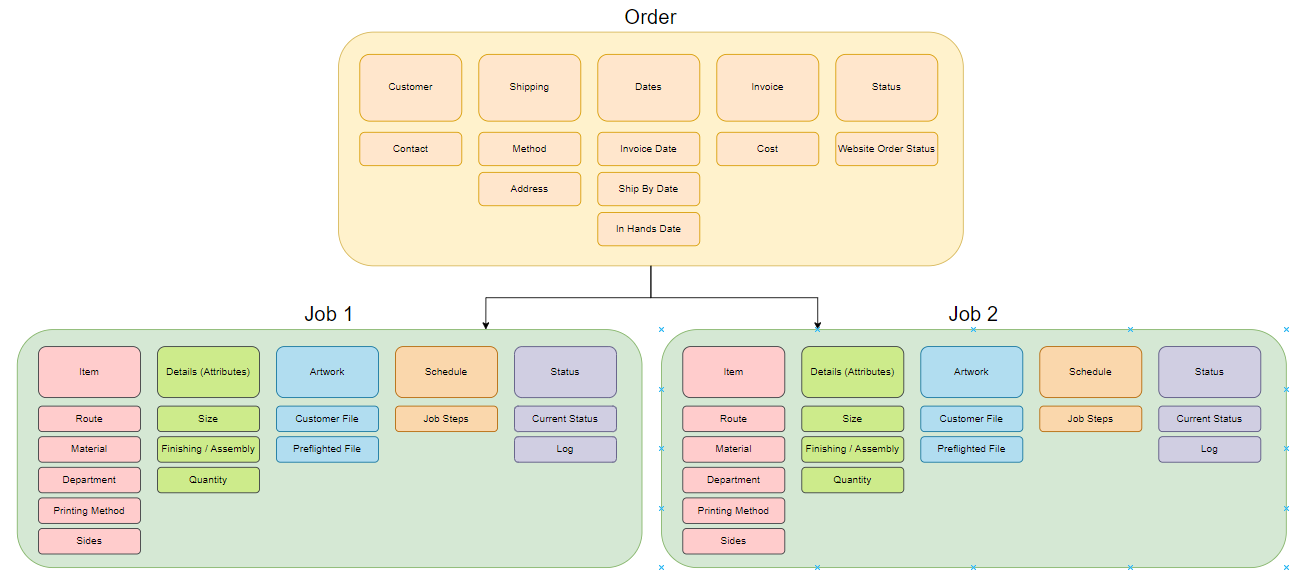

So what we do in our system is break customer requests into "Orders" and "Jobs." These are internal names and not really industry practice, but it's how we do it at FireSprint.
An ORDER is the invoice, or shopping cart basket on our website. An order generally has one ship to address and one due date. An order stores the information about the total price (Total, Tax, & Shipping) to the customer, It's a way to group jobs. There is NO artwork, quantity, material, etc attached to an order.
A JOB is the invoice line. Jobs are what you are probably thinking about when running through your system. Job has artwork and specifications.
Here's the way it looks in our system.

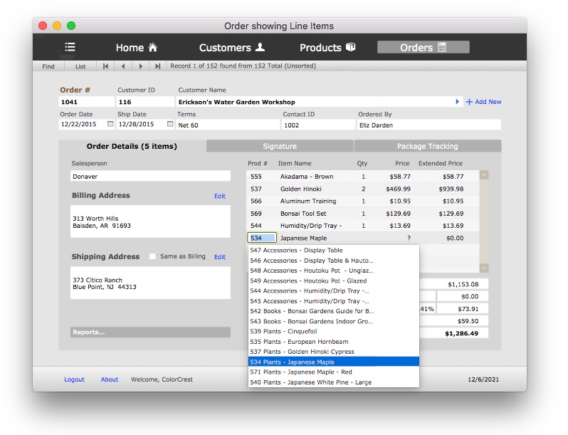

I was wondering if it's possible to have multiple items on a single order?
The attached image is directly from a free Claris FileMaker training series of working example files. In this particular example, simply clicking into an empty Line Item portal row will invoke a drop list of products to choose which is sourced from a separate products table. In this very typical database or spreadsheet model there are three tables involved; orders, line items, and products. What is different with sign shops is they want / need to track the individual components which make up products. So, another table (or designation) of components is also required beyond the more commonly available solutions.
EDITED TO ADD: (It’s possible to use a “Product” table and, by designation, hold products and components together in the same table. That, however, is technicality beyond this discussion for the time being.)
