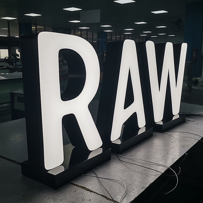

Have a customer looking for what I describe as freestanding (mounted atop a retaining wall) lighted channel letters, around 4' high letters.
Kind of similar to attached image. Would like to buy from US vendor, the closer to Cincinnati, OH the better.

You'd be better off attaching your letters to a bottom mounted raceway, as wiring going through the top of a wall, might be a little tricky. Even your pic has a base. I'd attach to the bottom front of the raceway and make sure the raceway is totally secure. Besides, you'll need to lift the letters off the wall for drainage.

We can make them you would need a raceway on the top or bottom depending on where its going. But we used an aluminum U channel once as well. We were able to bend on a curved wall. It was I think a 2-inch U channel. We build the returns by hand. Cut the backs and faces with the CNC. We also automate our 3-inch and 5-inch-channel letters for wholesale. If you need a permit and install in where you are at. We are part of a national certified sign manufacturers and installers network called Sign Search www.signsearch.com. I found them at an ISA show in Vegas many years ago. We can find you installers anywhere in the us. Ship and install. our site is www.iSignDesign.com if you still need them or have a need in the future.
