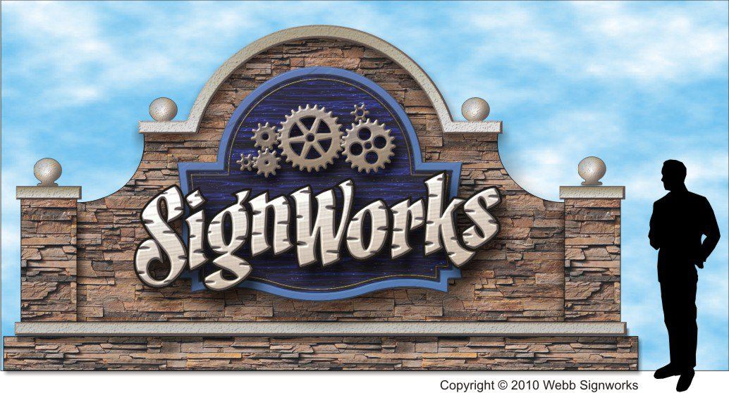

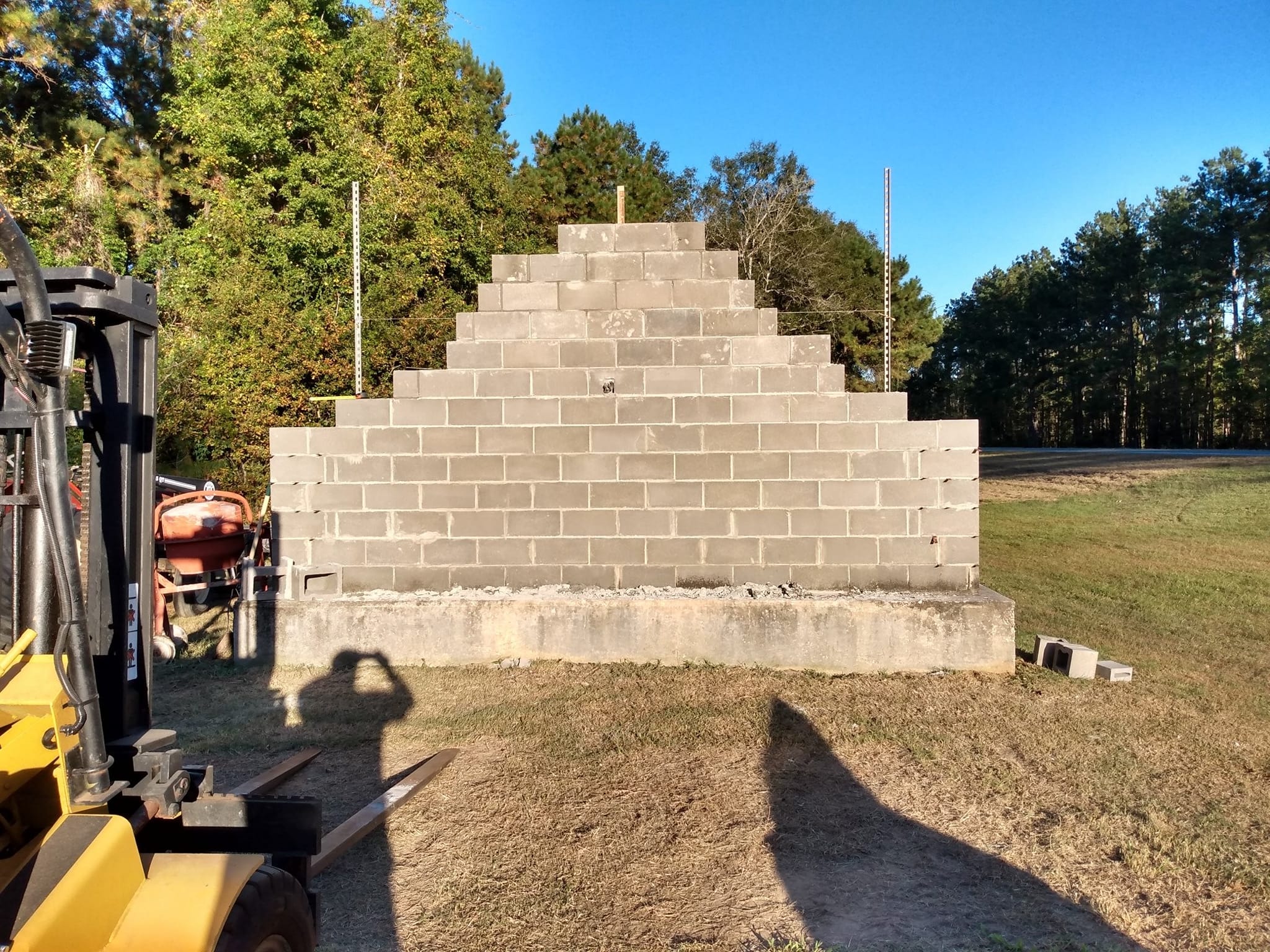

Getting ready to hang a large HDU and aluminum sign on a block wall. The sign will weigh between 100 and 150#. It's going outside so anything wood or plastic would probably nor work so I found these aluminum French cleats. Does anyone know of a better alternative? Thanks https://stingerich.com/french-cleat/

What's the sign made of..... meaning how is it backed up ?? Do you have a support system in place ?? What is the height and width of the sign ??

Why cleats? Is that sketch from 2010 the sign that's going up? Will the wall have a stone veneer?
Personally I would go with clips, especially if it's stone veneer. That way you can make a template of the sign shape
hold it up to the wall and mark where the clips would go avoiding any spots that would have issues with drilling.
