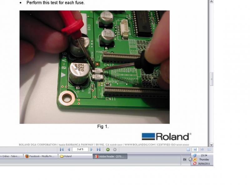

Check out the F2 fuse on the main board. If there are no nozzles on the test print, that's the cause for sure. It;s a small ceramic fuse 3,15 mA value. You can put another one there instead of that with a similar value (not too big - arround 4mA) and this should do the trick.

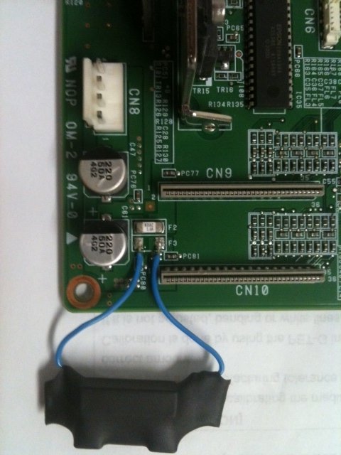

AAAAAAAAAAHAHAHAHAHA!!!.....Triumphant scream.
It was the F3 fuse that controls that side. They seem to run in parallel for some reason but the one was definitely bad. I don't stock 1.6amp ceramic fuses but I do have some tiny wire, a work bench, and a True Value near by. Hell, I may replace the other one too.
We're back in business. Nozzles on test prints are cleaning up too.
Gabriel
It's not a standard fuse from glass. It's a small white ceramic fuse and it meassures less or 1 cm I suppose. It is placed on the main board.The one made of glass belongs to the power supply board.
