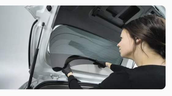

Bengt Backhaus
but the white reflective needs to be white facing out the window
Is it a car window or an office window?
For car windows i have mounted the reflective on a thin rigid plastic cut to size that the customer slid in under the rubber around the windows on the inside.
Kind of like the window tint you dont have to install permanently.
For store/office windows i have done the same solution but mounted the sign with clear doublesided adhesive.
