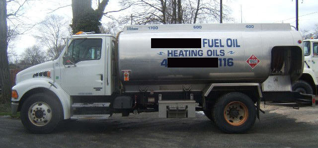

Hey guys, I have to go tomorrow and bid a job on re-doing a companies fuel tanker in a state nearby (PA)
I don't know the measurements just yet but i do have a photo of the truck that needs replacement graphics. Guessing they may be 2x7'?
If that sizing is the case, Without removal i'd be at $364
What price range would you be at with this job? 1 color, cast vinyl and just the two sides with the 3 lines. I will be removing the old vinyl also.
Thanks!

I am working on getting them down, Just asking the folks here their input
OldPaint
trucks that size have RIMS ........20-22" across. the drivers side door, 36-42" wide. scale it from those. you sizes, 2 X 7=14 sq ft X 2 =28 sq ft X $10 s.f. = $280.00. removal of old vinyl, clean and prep, at least $10 an hour. i would say at least 3-4 hours. $280 + $40= $320.00..................+ travel............

For $10/hr I'll stay home. You can't cover your overhead and other expenses at that rate. Not to mention $4.00/gal in fuel.
CheapVehicleWrap
2 trips out of state, layout and install tanker; 364 bucks.
I'd say you have your prices down. Way down.

Vinyl and adhesive removal runs apx $75 -$100 an hour.
$10 an hour labor rate? Rapid remover is close to $50 a gallon...
GAC05
Quit buggin' me
Steamer would be way cheaper if you have power close by.
With an unpainted tube like that a well lubricated stainless steel scraper could also be used without damaging the tank.
I am with you on the $10.00 an hour being too low.
Just because something is out of state doesn't mean it's far away.
I live on the mason dixon line which is the division line between MD and PA and place is 2 miles away from me.
BTW, i just noticed in my pricing software i selected calendered vinyl instead of cast, yikes! The cast price is $450 not including removal.

I SAID.......$10 AN HOUR....for easy figuring, make it $20, $30 or $65........it was just an example........brainics))))
Jillbeans
I hope you are using cast. The last one I did was $500.

Came within $34 of my competitor on this job. I'd say my pricing was spot on after re-configuring my new program!
Thanks everyone!
