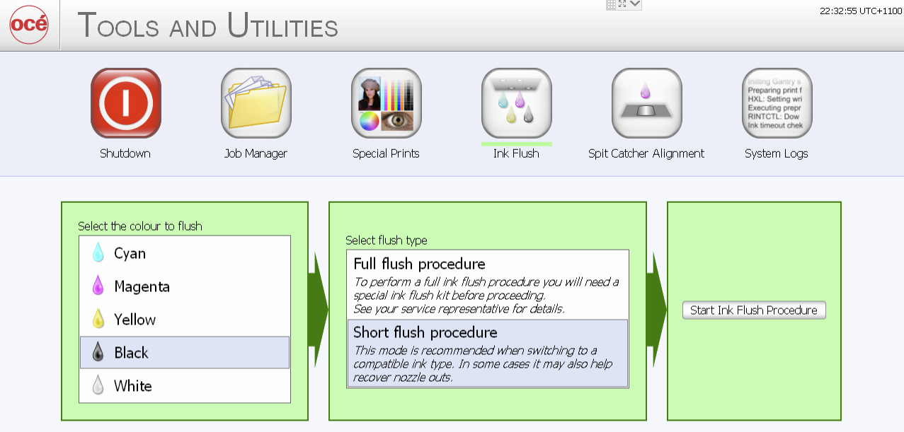

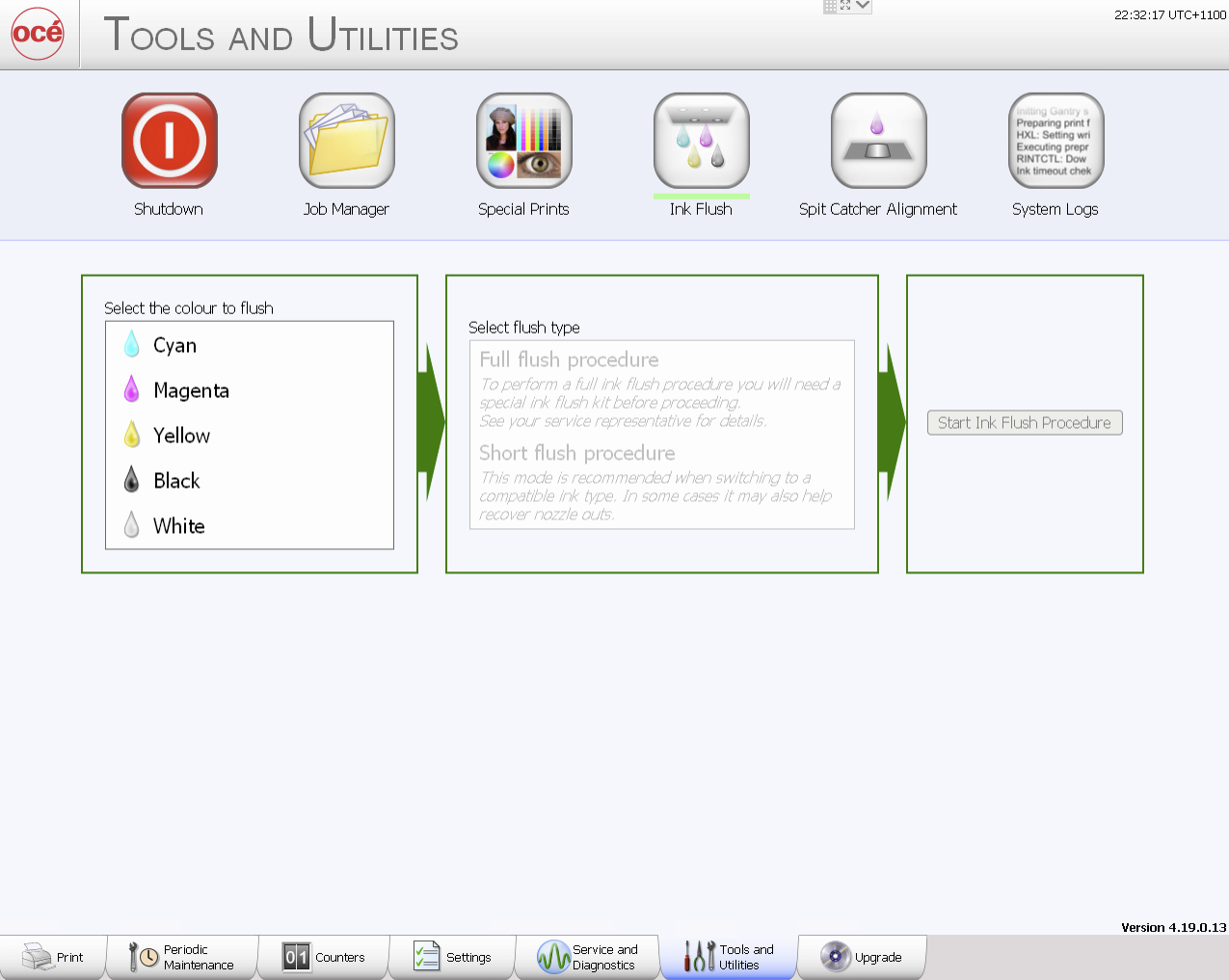

Try running a short Ink Flush on the K channel from the Tools menu (assuming it runs something similar to Oce Calgary software). Make sure you have at least half a bag of ink available for this procedure. It will dump a lot of it, also empty the waste tray before hand as well.
