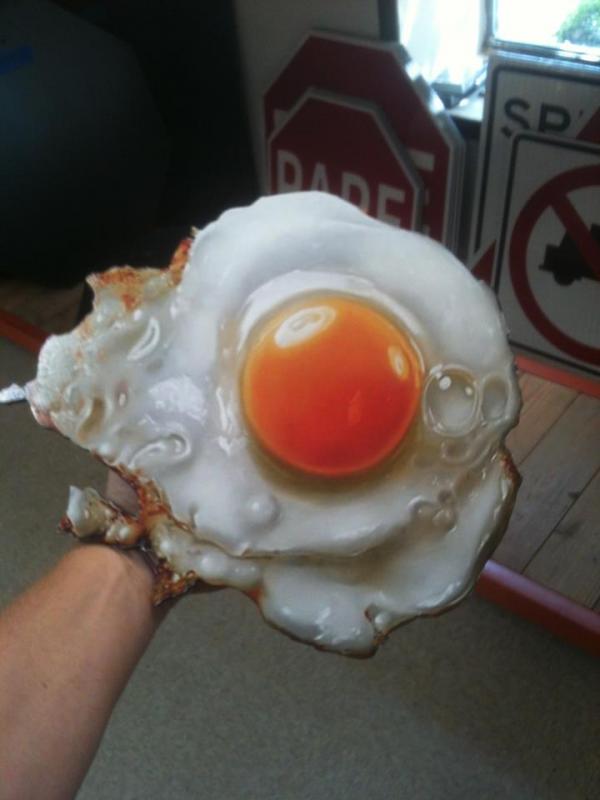

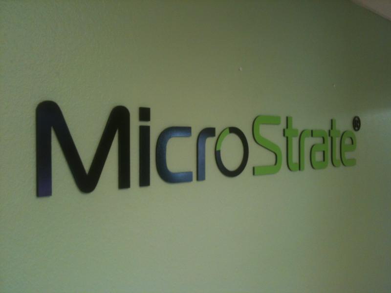

ask and ye shall receive
pics of some of our finished products
