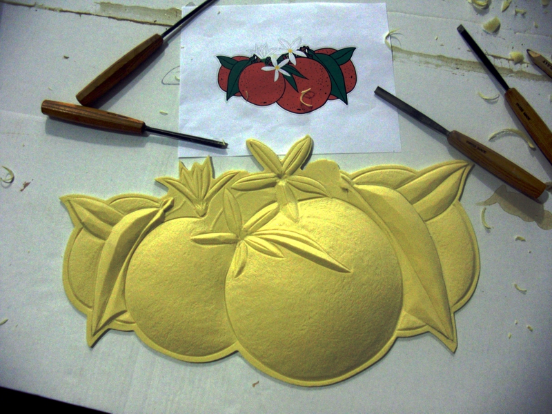

So I'm working on a large blast carved cedar sign featuring an orange pictorial on it and thought it would be therapeutic to get out the chisels and have at it. Next I'll paint it the colors shown in the print out above it. Sometimes it's nice to get away from the computer for a little while!

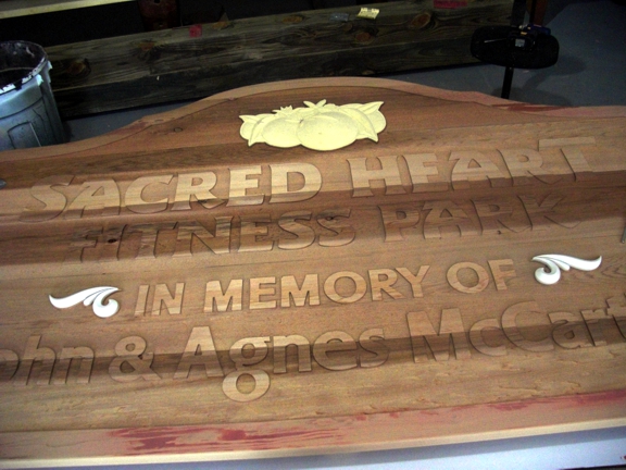

Blasted the sign yesterday so here it is in it's raw state before getting finish sanded, primed and painted. This sign is 5'h. x 8'w. I decided to do the little scroll pieces with a prismatic bevel.
This should be completed by the end of next week. I'll post a finish shot of it then with the color on it.

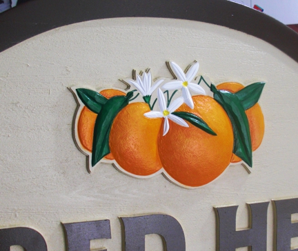

Pat the oranges are carved from some scrap 15lb. HDU. I used some scrap 3/4" PVC for the prismatic scroll pieces. The paint is Behr premium exterior semi gloss house paint usually two coats on top of Zinsser oil base primer on cedar. Oil base because the tannins in the cedar can leech out. On anything else I would use a water base primer. That's about all there is to it..
SignManiac

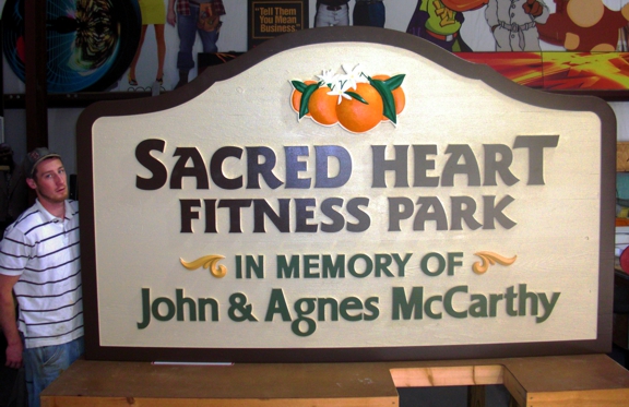

Updated:
Here she is painted. I won't be installing this one, the client is. I'm satisfied with the way it turned out.
