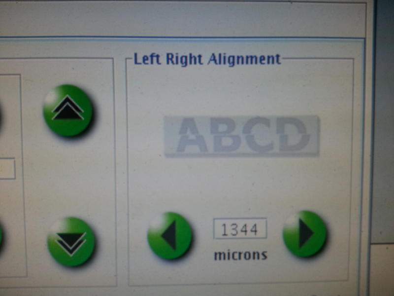

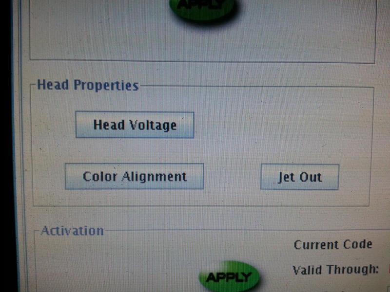

So getting back to your issue, there are only three test that are worth worrying about, the rest are useless.
1. Jetout
2. left - right alignment
3. color alignment
I know you know how to do a Jet out, and probably know right - left alignment, but do you know how to properly do a color alignment?
That's where most of your issues probably are.
attachment.php
attachment.php

Charliekarly
Sorry I did not get back to you!
We have been really busy with the Holidays. I have not resolved the issues, I have just been kind of working around them. You posted a picture of the left/right alignment, I have never touched those numbers.. How would I know what to adjust them to? The left/right alignment in the user manual only talks about the head height being accurate. I did fiddle with the head voltages in the black, and whether I went up or down I could not notice a difference in the jet-out test lining up any better or worse. Not knowing a whole lot about this press I am too nervous to bring the voltages too high or too low.
