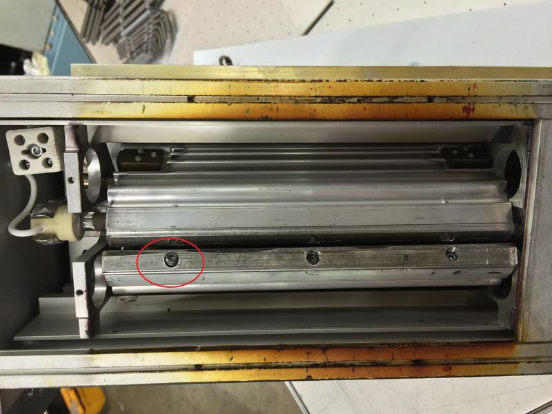

I won't bother with the low vac tubes but right now I ran in to a problem.............. a screw came loose in one of my shutters for the UV lamps, it scratched my quartz glass, and it won't go back in, I think the hole that the screw goes in to is stripped. I even tried another screw and that wouldn't go in either. My question is can I still print if I just remove the screw? I will attempt to attach a photograph. TYIA!

Andy D
Yep, our's did the same thing, but you're lucky, the screw managed to bend the crap
out of one of our shields & if I remember correctly it was $1200 just for the replacement shield.
I would say heck yeah, you should be fine with the remaining two screws.

Thank you so much!
You have been nothing but helpful to me, I really appreciate it! I was actually able to get the screw back in, I was unaware there was a nut that slides around in there. After taking a closer look I was able to use a really small hex key to move it back in to place and fix the loose screw! I will remember for next time that (if need be) I can go without the screw! I like to listen to my press while it runs, so I was lucky enough to hear where the sounds were coming from and pinpoint the issue! I will come back to this thread if I ever have any more questions! :)

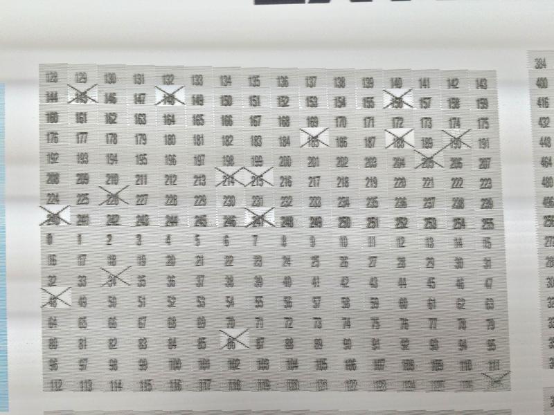

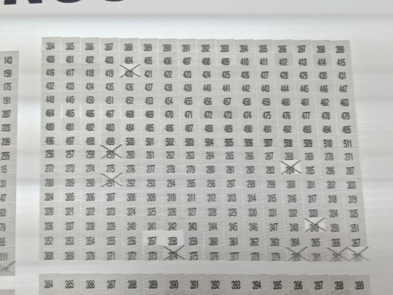

Second, I am having issues with my black heads again. Sometimes the black won't print through all the nozzles but not as bad as last time. My main concern is that this is a new head (a couple of months old) and it has already started to look pretty bad in the "Jet-out" tests. The bottom rows are blurry, the numbers aren't printing clearly, and there is an issue with misfiring nozzles and what-not. When I am printing black copy I get a really poor quality print. I do not want to have to replace this head every couple of months!
Here are a few of the adjustments i have tried.
-I raised the head voltage up to 110 (from 107) in heads #10 & #12 (the 2 front black heads).
-I raised the ink reservoirs for black by 2 Degrees (now at 47 while the rest are at 45)
-I raised the head temperatures by 3 degrees (not at 50 while the rest are at 47)
-I wiped the print head with solvent during a prime
-I adjusted the color alignment

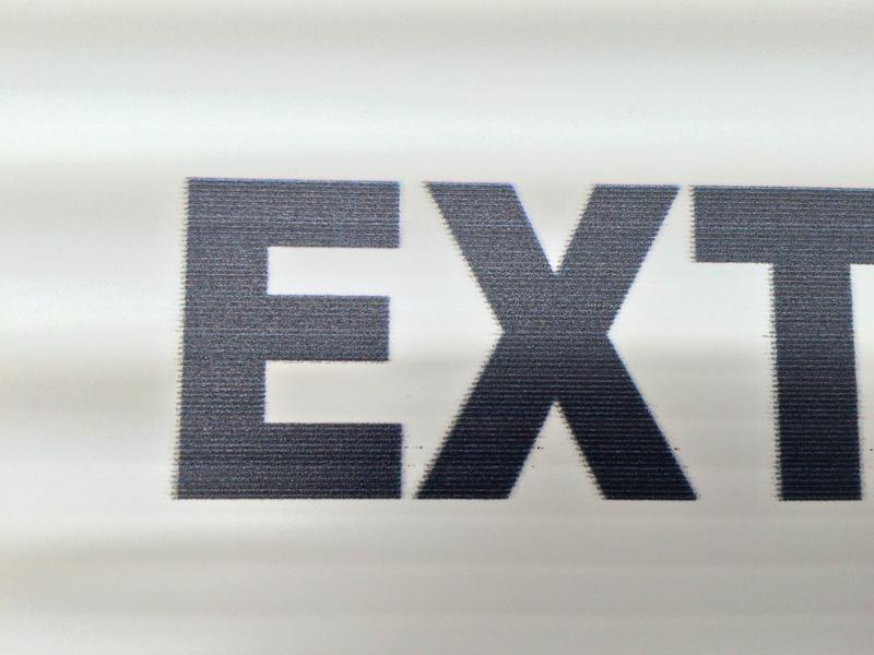

I will attach photos of the "Jet-out" test, and a sample of the quality i get printing black copy.
Any and all suggestions will be greatly appreciated!

1st off, you see how you lines in the jet-out that starts at 128 are mostly even with each other left and right?
That's how it should look if your voltage is set right. Your heads starting at 384 are set too high or too low, you need to
tweak your voltage until they line up.
It looks like you're not running all your head at 100%, right? You're tweaking some higher some lower to adjust the color , correct?
2nd your jet out doesn't look bad at all, Mine is much worse than that and print much better than what you're getting.
What do your other jets look like?

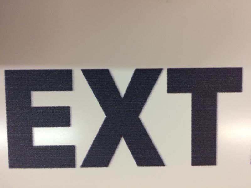

Can you reprint the "EXT" in uni- direction so we can see how it looks....?

The colors are ALL at 100%.
all of my other jet outs are beautiful except for the black i showed you and light magenta has been iffy since I got the machine.
The first sample was at 12 pass 100% Bi-Directional on coroplast. I am getting ready to leave for today so all i got a picture of was the same file at 18 pass 100% UNI-directional on max-metal. Tomorrow I will use your advice and adjust the head voltage until they line up.
