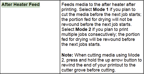

Is there a setting to adjust the gap between print jobs? We recently bought a SureColor S60600 and are getting a 10-12in gap between jobs. It appears to roll the substrate out in order to complete drying the job, but then doesn't roll back after drying like our HP does.
SignMeUpGraphics
Super Active Member
Have a look in Epson Edge Dashboard and check to see if the media type has an After Heater Feed enabled:
Sounds like you might be on Mode 1. We have ours off on all profiles.
