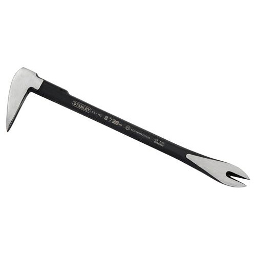

fmg
This is an excellent little tool that works well to prise off stud mounted letters.
I have taken many letters off different surfaces using this tool.
Acrylic letters will need a little more care.A small tool with a huge result and a very affordable price
Good luck
