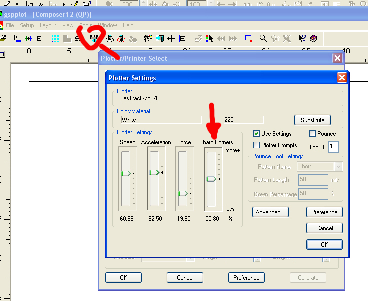

as stated make sure the blade is out only a tiny bit, play with this setting in Omega (see image), it will alter your blade offset.. also check the tip of your blade has not been snapped off?..

Thanks for your help yall. Yes I did have the blade out too far.. I have gotten that fixed and the letters are coming out much cleaner. I appreciate your help very much :)
