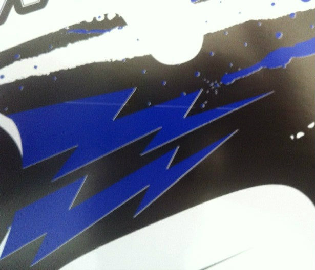

As for Friday my edge started not printing in a spot. It leaves a white line straight down the print. Does this mean my print head is going out?
I've cleaned it a few times with alcohol wipes but that has not helped.
I print black as an overprint and it prints fine but does leave a notable line.
Here is a sample image of what I mean.

wrinkle in the foil?? or does it happen all the way down the print parallel to the vinyl's edge? If it is a parallel line no matter the color, then you have a pixel out on the head. If it's random, it's a wrinkly in the foil. Happens to me every once in a while.
Coban
Does it on all the colors but black. But I think thats because the heat setting during overprint (?) If the pixel is out.... whats the damage?
smdgrfx
If you have a pixel out, then you will need a new head to fix the problem. Or you can design around it, which I've seen people do. I've not priced a new head, but probably a few thousand if not more. I just bought a small gear for my Gerber plotter a few weeks ago. Was $220 plus shipping. They are proud of their stuff....

If it doesn't leave an unprinted line on any foil you try then it most likely is not your printhead. The first thing I would recommend would be to remove your covers and remake all your connections by unplugging them and then plugging them back in.
