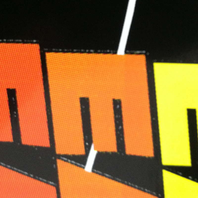

I seem to be getting dots when the top layer of foil is overprinting leaving white dots all around the overlap. I was wondering if anyone has seen this before? It's a new issue, would static or a pressure setting cause this? I have tried changing the darkness but no luck.

is the choke/spread created in composer? I had a problem with it doing that because it was printing two passes of the spread color instead of all at once. You may try switching the print order so the color is on top of the black, and the black is printing in one pass..
If the black is printing all at one time, make sure there aren't two seperate shapes butted together right there because if they aren't perfectly the same it might cause the little gap.
Maybe since you're printing over those halftones it's causing it.. like I said try laying down the black flood first then overprinting the halftones instead.

This file is Process but I have tried over laping 2 spot foils and the same thing happened.
Yeah I haven't tried printing the black first because I've always had it work on top, but I can give that a shot. It would be a temporary solution for this job but it always looks better if the darker color is on top.

Yeah I don't think it is a material issue, I've been printing this file for 7 years and this is the first time. Does anyone know what happens if a print head starts to go bad? I'm also starting to see a few tiny dot's in solid prints.

So I have tried printing the black first and the Y and M on that but now there are white dots where the black stopped. It is hard to see in the photo but the y and M are printing past the black.

it looks like the foil is being lifted in the areas where it is overprinted. I asked if you reset the type of vinyl on the plot page as I had some issues and it helped. I print a lot of the Gerber ImageCal R and I started having issues with speckles and it looked like the foil didn't want to stick when printing solids. once I changed the setting, I haven't had any issues. changing the vinyl type changes the heat settings (I think)

Sorry about the delay but I've been fiddling around and I'm wondering if it is the voltage coming from the power supply. I switched the print head into an edge 1 and it is printing perfectly. I'll check the power supply on the 2 and see if I can get that outputting correctly, but for now it's back to the edge 1.
Thanks for all of your ideas and help.
