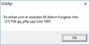

Hello,
anyone got a clue as to why we got this error message in GQMgr when sending a job to our edge2?
It basically says that "A unit connected to the computer isn't working" (see attached screenshot).
After a restart it's working again.
Computer is running Win10 pro, and Omega version is 5 (latest update according to Help menu 'check for updates').

I have been running into the same exact issue recently; with the exception of the error code listing "Line 1270." Same as above with Stefan but using windows 7.
Any help with this would be appreciated.

Unsuccessful.
Error prompted again after loading the job onto the Edge II, still listed within queue in GQMgr. Checked folder, file not present within the folder path despite being present on the queue list within GQMgr for the Edge II.
Went into Properties within GQMgr and using the device's "Info" button, relays back "Device is On-Line" which is what the Edge II's LCD displayed. Edge II still not prompting the job on the LCD display. Terminated the job from queue, retried "Info" button and prompts "There was a communication error with the device." Unplugged the USB to serial adapter on the comp, replugged, sent job again, works... currently awaiting issue to occur again.
