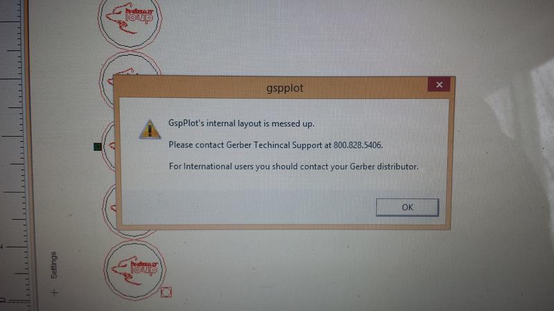

Fred: I've tried to put my 5 vertical rounds in composer and create the remaining in gsplot, but it stop exactly at the same place. It's like if the file is not rip fast enough for the printer (I'm just assuming this).
Now, this morning, I had this popup coming out (see picture)
The printer pause, as I understand it, is simply what happens when the Edge is communicating with GQMgr for more data. It is normal.
The message you got is something I have never seen in 18 years of running the Edge.
I may be able to tell you more if you will send me the job attached to an email to the address in my signature. Send both the PLT file and the PRM file with the same job name. Include also what version of Omega you are running.

if you have 'real time protection' turned on in your antivirus software, it might be trying to examine the data as it's sent, causing throughput issues.
Marlene
did you call the number on the message for tech support and ask them? a long time ago, I had issues with the Edge stopping about a foot into a job but it would never restart. my issue was the setting and once changed all was OK. that message is oddly worded. try calling them as that is the tech support number and see what they say
