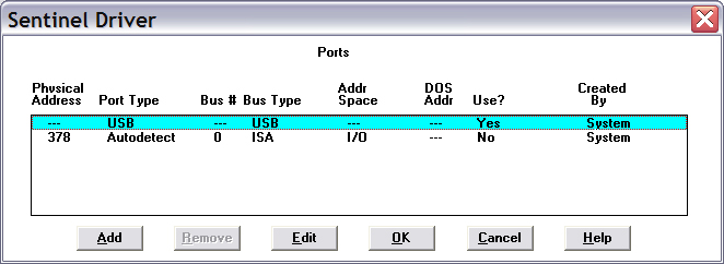

Check your Sentinel Driver Config. It should be set to Yes for the port where your security dongle is connected and to No for the port that is connected to the Edge. You should also insure that there are no jobs ahead of your job or just sitting in your Production Manager.
