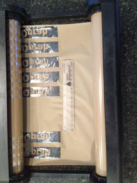

Anyone ever seen this many pixels blown in a row? Or possibly something else.

does it show up in gsplot? perhaps those 3 are accidentally set to use a different vinyl?
I dont know. Its a setup that is for sale. I thought it would be odd that there is 3" of the printhead just dead. I know usually it will just be a single pixel or so that does not print.
This leads me to think there is something else wrong and possibly just operator error.

I guess I will have to go and try and run the machine and check it out. The owner has no idea how to run it.
Browner
My guess would be print head data cable.
There are some built in print tests in the EDGE LE and EDGE II that don't require any computers to be hooked up to the printer. There must be some way to do that with the FX.

Anytime we have had similar malfunctions, we have copied the file and pasted it into a new workspace, saved it with a new name and used that as the production file. This has always corrected the problem.
Tony Teveris
One thing you can do is once the job is setup in GspPlot save the job as a spool file with both print and cut data. If you are using the later versions of Omega (4 or 5) you can use SplView to look at the "ripped" data before printing, if SplView shows the gaps then the problem is in the software, if you print the job (which views ok) and the gaps appear then the problem is in the printer.

Well I picked up the printer and its an edge II
I did a print test (solid block) and there is still a solid block of 2" not printing.
