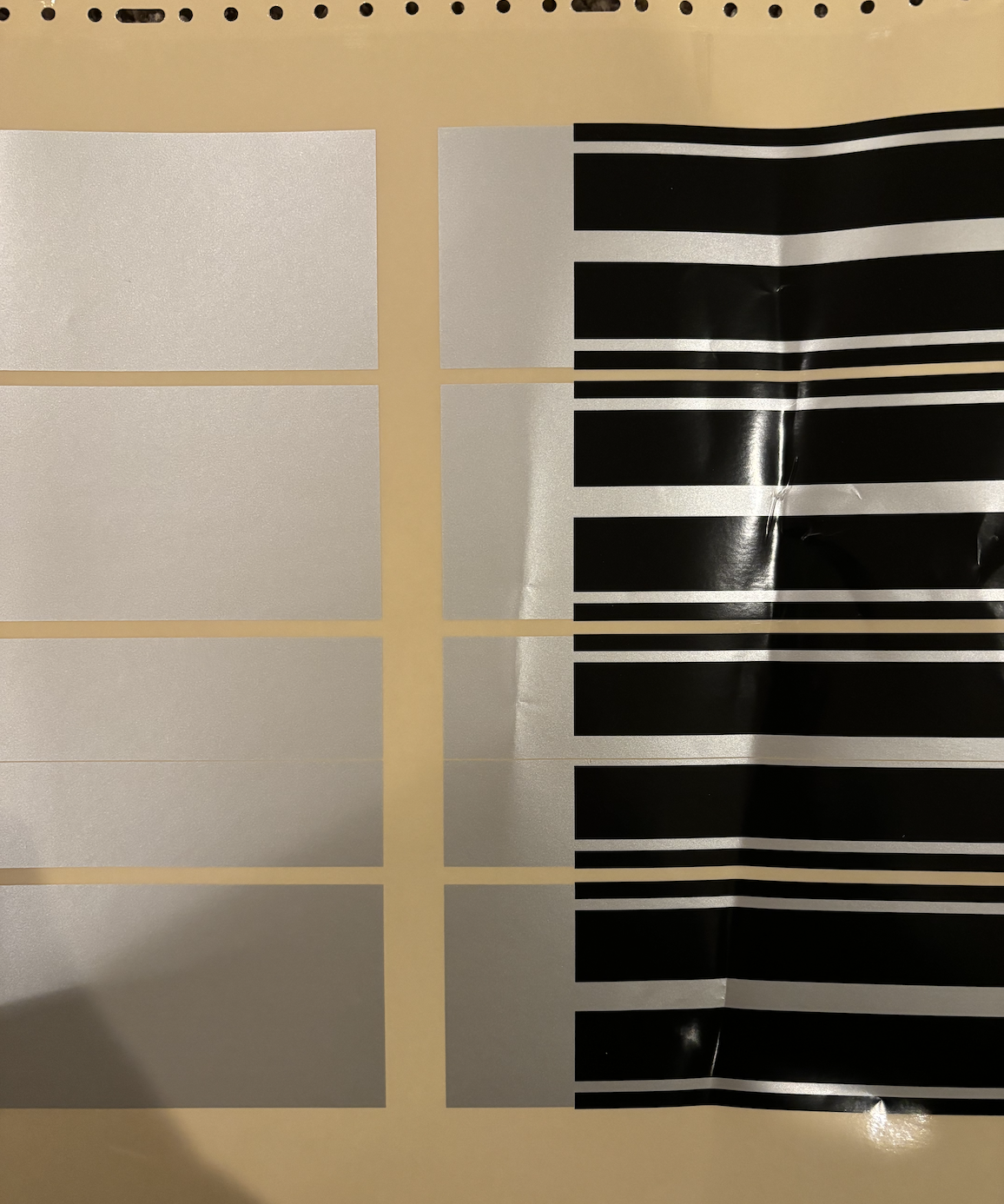

I am printing on my Gerber Edge LE and the following happens:
I am printing black on top of silver, the silver prints perfectly but when the black is loaded in the printer will go a foot or so and then rapidly beeps at me. I have tried different foils and still have the same issue.
A picture of what is happening is attached. The print will just stop and Edge beep like crazy. I cannot reset or restart the print.
Any input would help!
(Silver now did not print this last run)

Update. Printer wont print anything. It will turn on fine with no noise but as soon as I send a job and click online and get to the actual printing stage, it beeps like crazy. Screen sits on "warming up" while beeping
