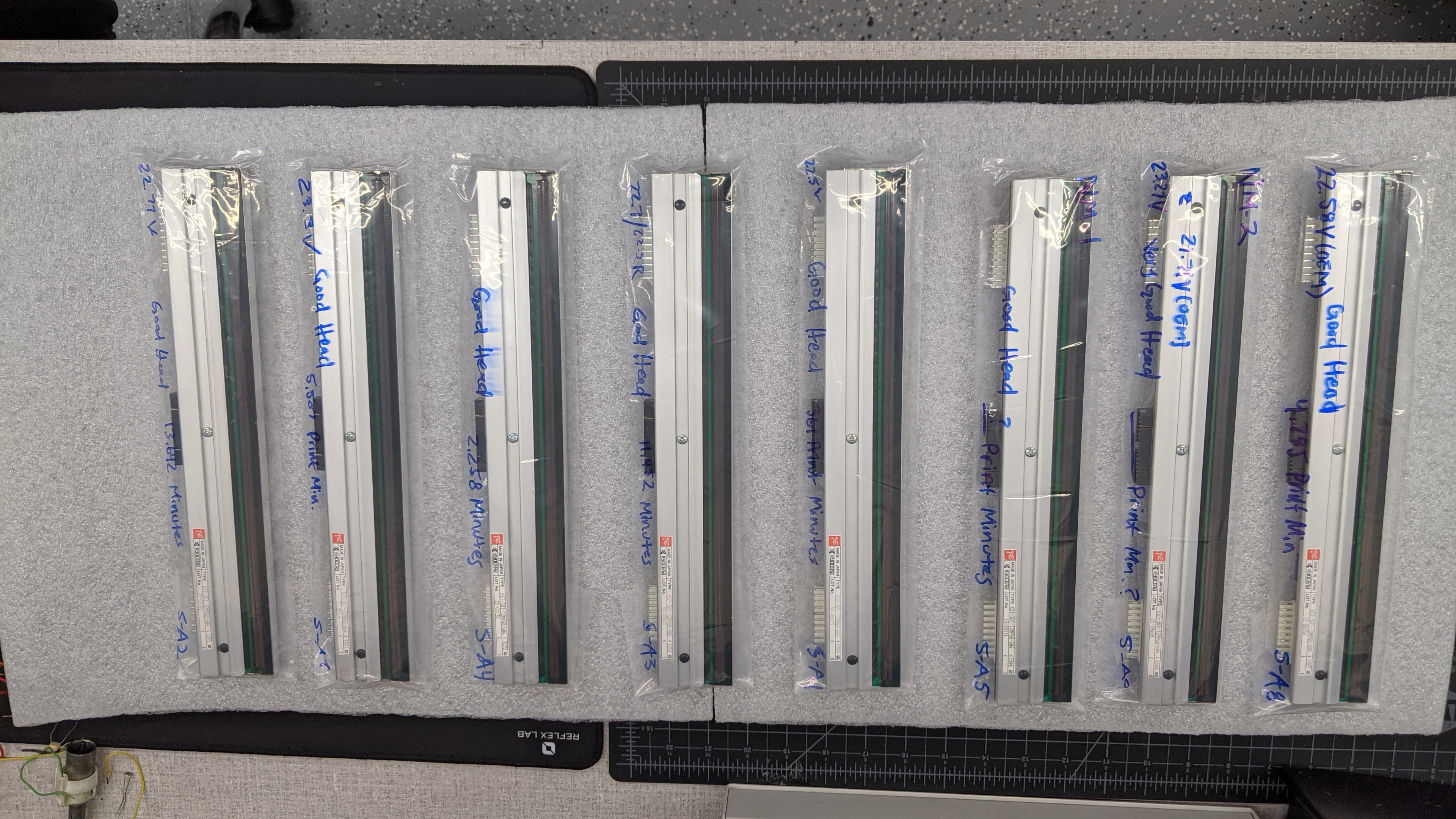

Gaugeco Inc.
If your worried about your Edge 2 having a ton of print minutes you can just swap out with a new head or have one as a spare!

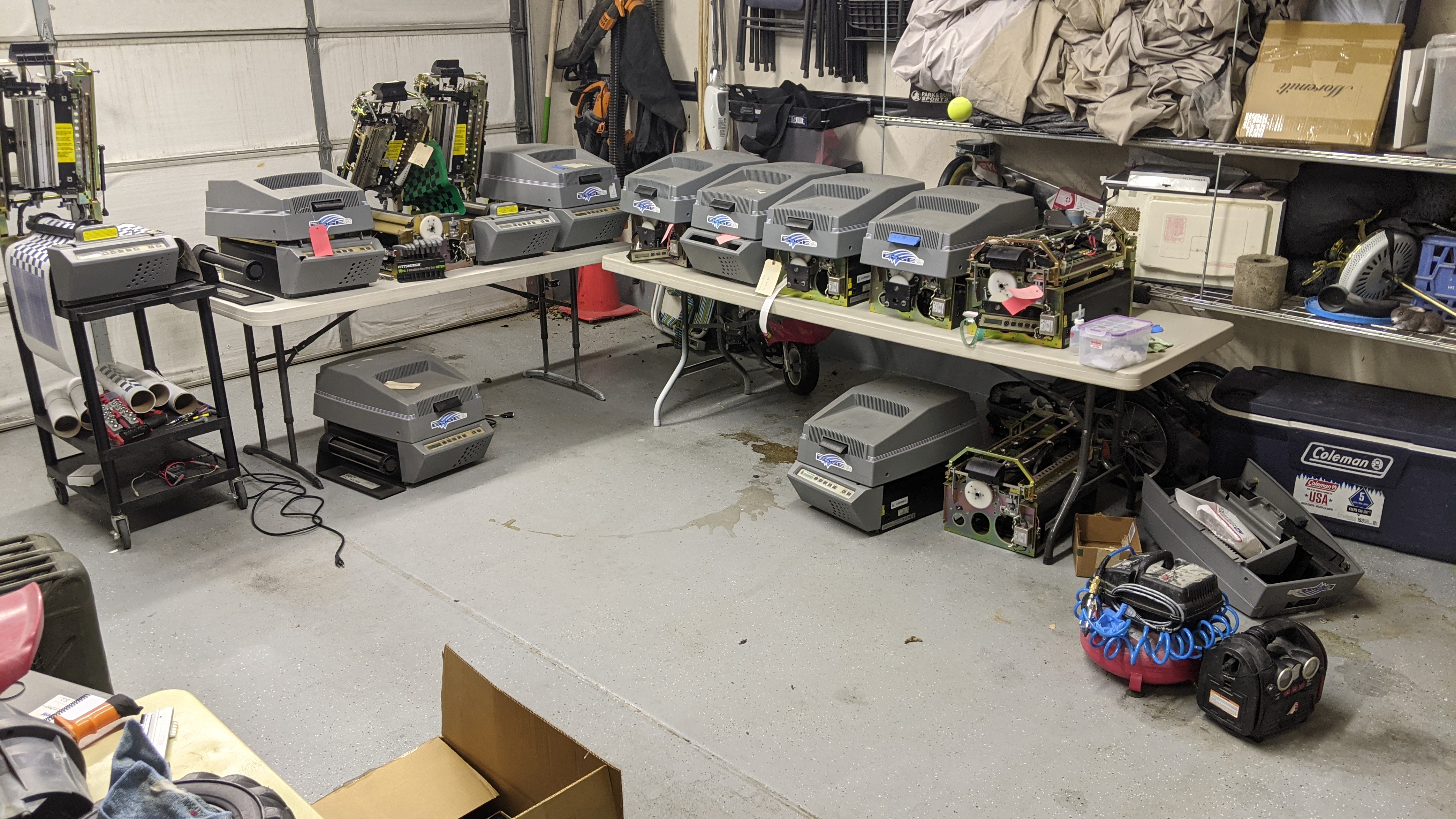

Gaugeco Inc.
I still have all of the heads. I haven't worried about putting them online or advertising them. I purchased a lot of printers from a repair company that was going out of business. I have parts coming out the Ying Yang. Here is my wife's garage (of course I moved them to the side and stacked them on top of each other).......but I still get harassed just about every day LOL.
