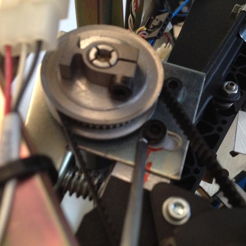

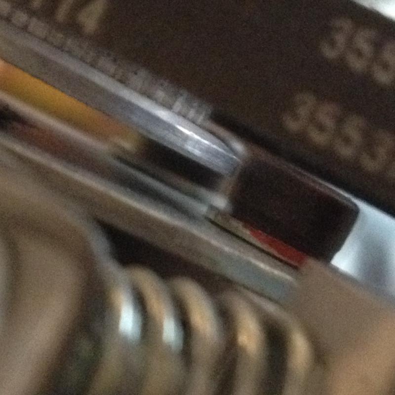

Hello there, well the noise is out!!! The problem was a "loose belt" and the pulley was touching the allen screw, I release the allen screw and "raise" the "metal plate" that hold the motor to "apply pressure" to the belt....noise out!!
