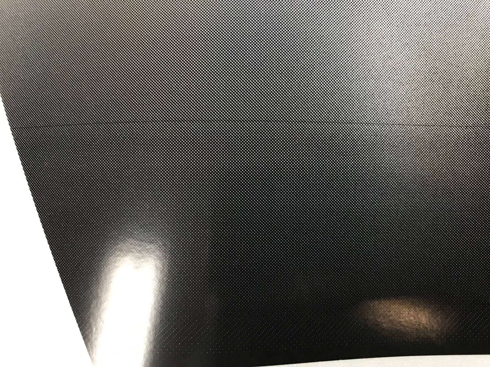

I have a file I am printing that has black fade bottom to top. After printing several with no problem there is now a horizontal black line appearing a few inches up. I cleaned the printhead well. Tried different foils and vinyl. Rebooted the printer. Disconnected and reconnected the cables. Any ever have this issue? I thought a blown pixel meant a white, unprinted line. Any suggestions?
Fred Weiss
Merchant Member
It makes me wonder if somehow the gradient in the file has a stroke applied to one of the bands ... if that makes sense. Have you reexamined the file itself in Composer?
Billct2
Yes, it fine.
I think I will try creating a fresh one and see if it happens.
I managed to get the job done by putting a blank box under it to shift it up so the streak was in the solid black part.
