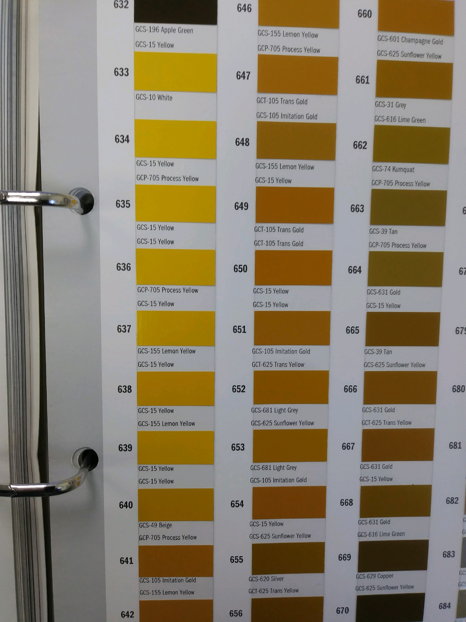

here is the page from the gerber spectrotone book that looks closest to me
bottom number is gerber vinyl
top number (over the swatch) is the foil number to overprint
hope this helps
