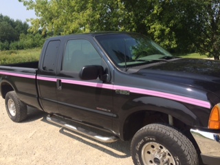

This is a picture of the truck that we were doing. We hid the pink stripe with a green stripe.... pretty basic stuff.
I know better than to take on a wrap job -- just more simple decals -- I was more or less looking for info on how you go around the door handles --- and giving you wrappers some props -- because I know that I don't want to do any wraps. Sub that stuff out to the guys who are good at it.
Mosh commented that you should remove the door handle trim. I don't see how you even do that. Does it just "pop" off? Not looking to wreck someones truck...
Mosh
Handles like those are the easiest, the ones that stick out we pull off.
I'd pop that emblem off though. Takes about two seconds with some heavy fishing line. Clean off the foam, apply stripe then VHB it it back on.
