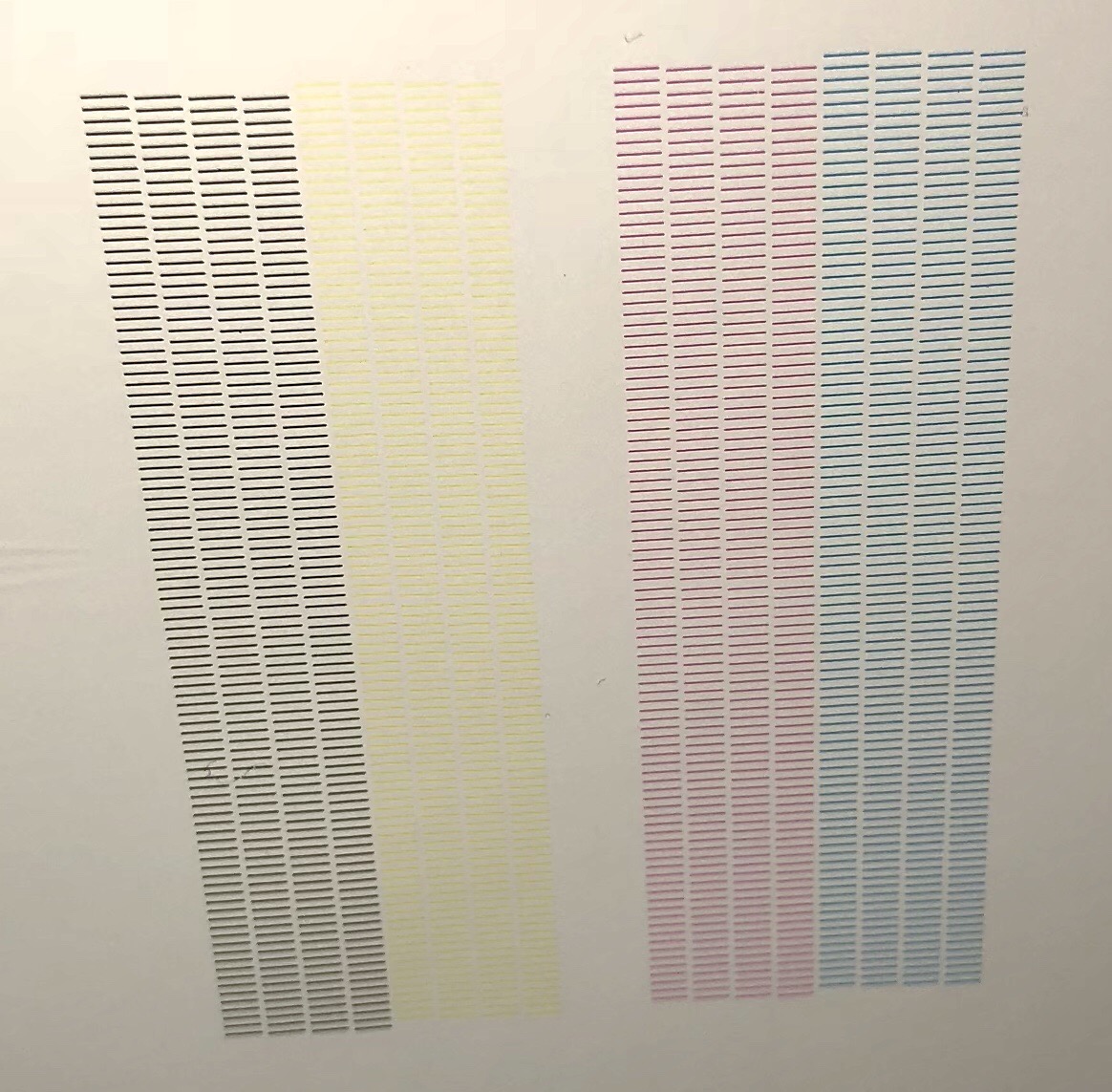

Hey there, I’m working with a less than a week old Roland SG 300. I’m using the testing media that it comes with. When I process prints, I’m getting a ghosted/duplicate print. It’s like it prints one copy, then overlays another copy just a mm off. Haven’t found anything that’d explain this and test prints look great. Any ideas?

Got a photo of a problem print?
A perfect test print isn't going tell us much.
It’s in the original post, the tip of an ‘A’ and in the trademark icon.
And I’ll see about testing the alignment too! Had a tech spend 4 hours configuring it, so it surprised me that it would be off like that.

The Bi-Directional Alignment is an end user function so it won't void your warranty. It looks to me like whoever did the alignment in the first place just got the negative and positive number backwards.
