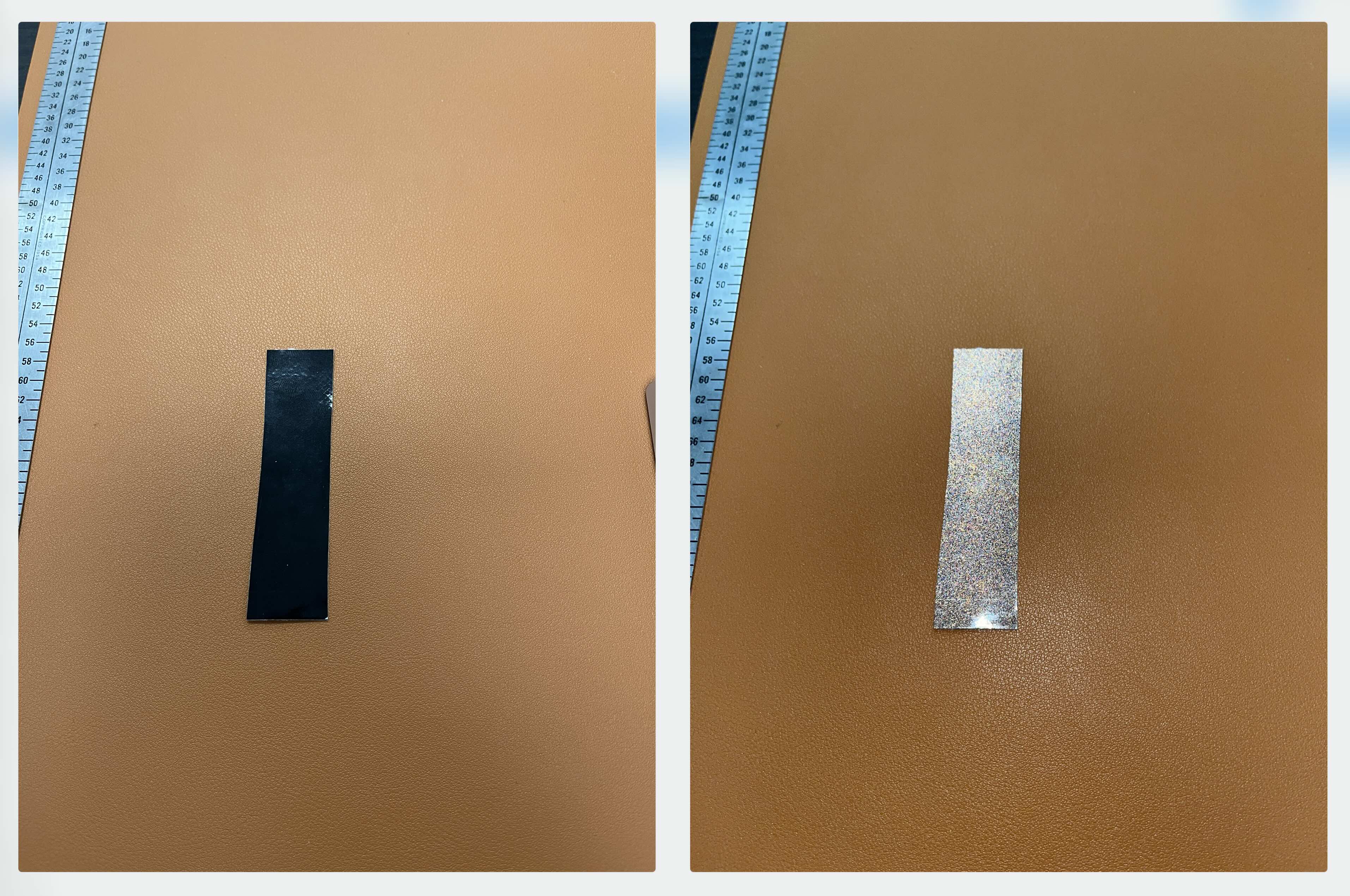

I’ve got some black reflective and it’s not like black vinyl. I’d say it’s a dark gray and might be what you are looking for.

For this specific order client has approved going with the black reflective.

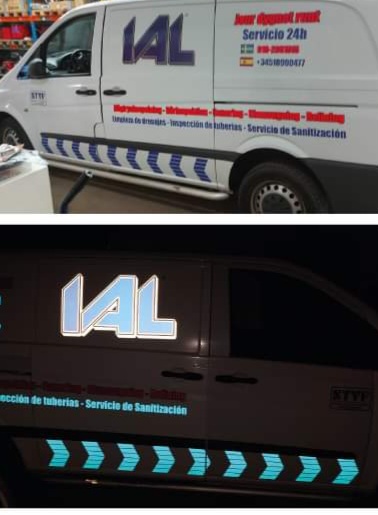

I use a HP 310 Latex and it prints very well on reflective. And I have had the same result on an Epson 40600.
In the picture the blue text and arrows are cut in Orafol blue reflective, and the IAL logo is printed on Orafol White.
