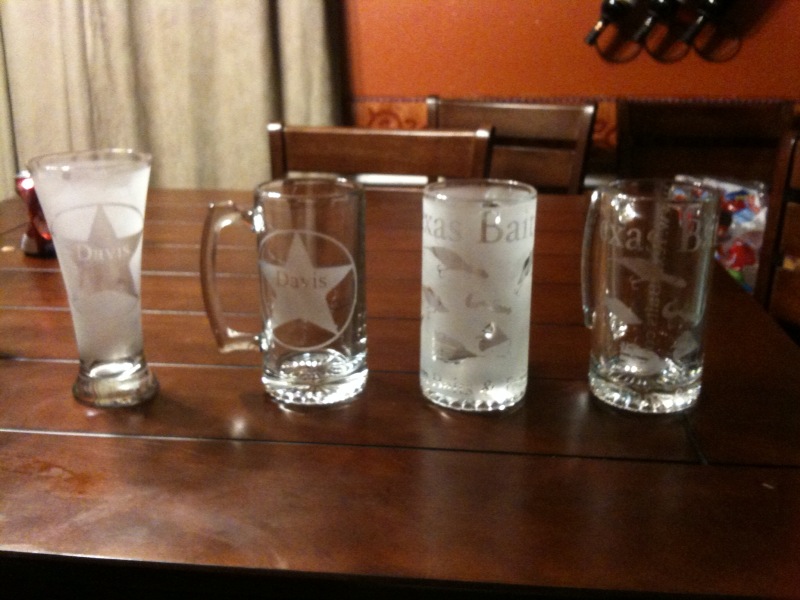

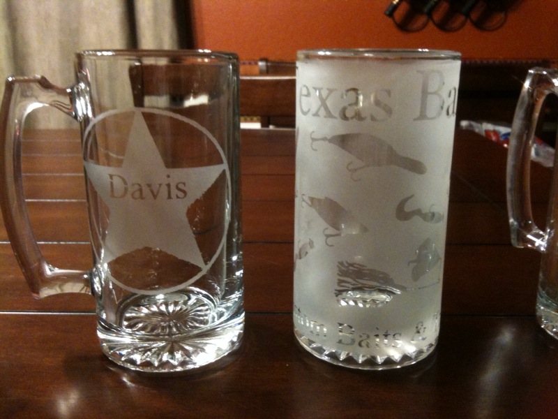

Ok I am thinking about etching glass shot glasses mugs ect an dplan buying a blast cabinet. Ok if I cut vinyl weed and stick on the glass lets say a logo what type vinyl could i blast? What blast media is recommended
Cross Signs
We Make Them Hot and Fresh Everyday
I use Oracal Paint Mask, It's heavy enough to withstand the blast and comes off easily
gunlocators

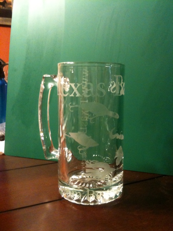

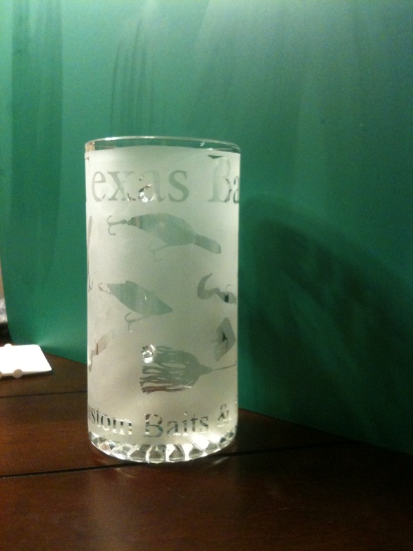

Thanks fo all the help used oracle 641 vinyl and did about 6 glasses today 1 was with etching creme had to apply 2 times still did not like the look so i bought a blast cabinet hooked it to my compressor and dust collector and finished other 5 pieces.
